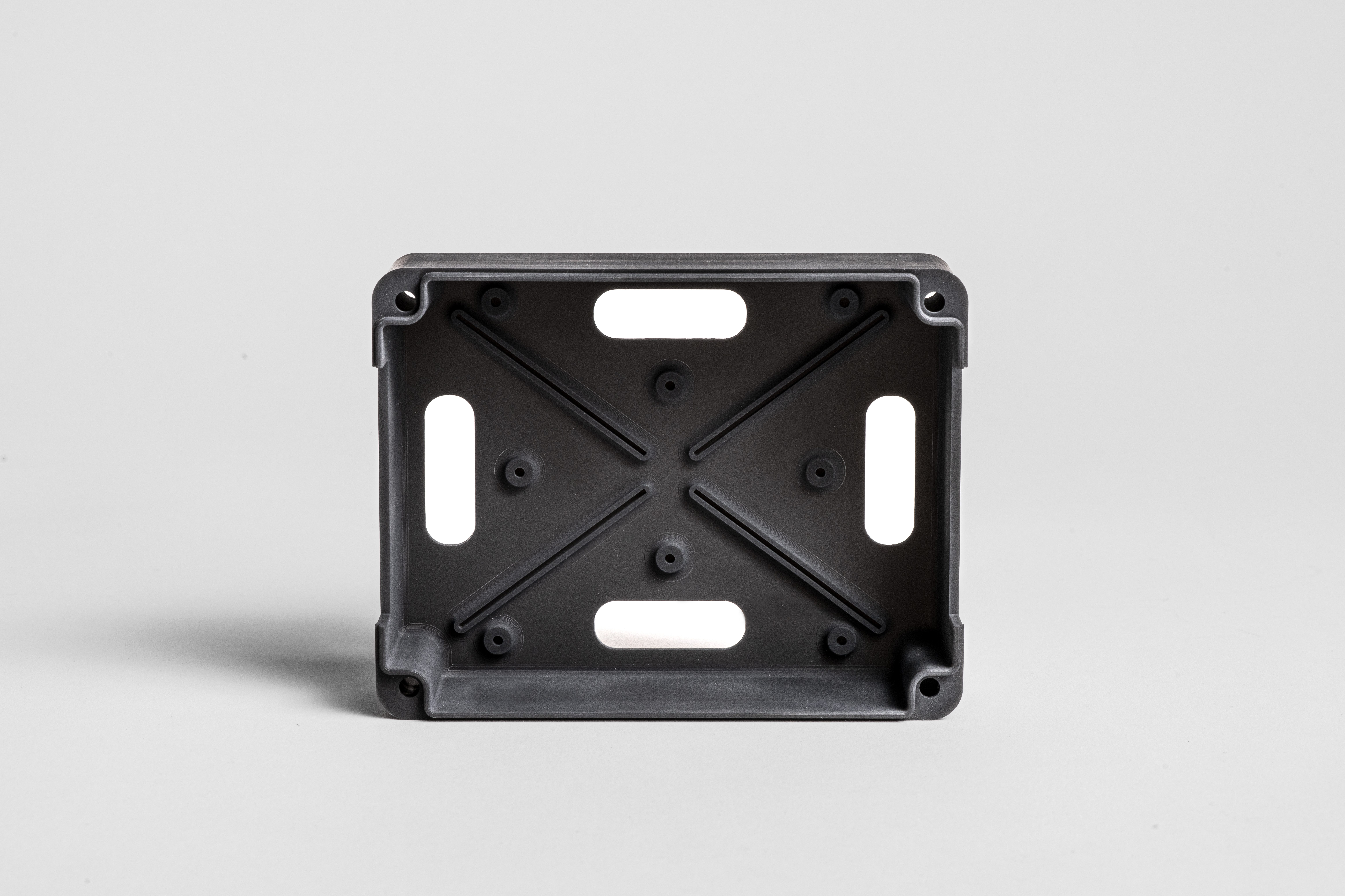

UL 94 classification in materials is the globally recognized standard for determining the tendency of plastic materials to either extinguish or spread flames once ignited. This classification system provides a critical safety benchmark for evaluating how polymers behave under thermal stress.
Selecting the right material is often dependent on safety compliance rather than purely mechanical strength. The UL 94 standard does not measure simple heat resistance but rather focuses specifically on a material's ability to self-extinguish and prevent the spread of fire through flaming drips.
By categorizing resins and filaments based on their reaction to standardized flame tests, you ensure that your components meet the strict safety requirements of your specific industry.
The science of flame retardancy: How it works
Materials achieve flame resistance through two primary additives. Some additives create a strong layer, which acts as a protective heat shield for the rest of the component. Others release free radicals that physically stop the chemical reaction that takes place in the fire.
The carbon layer acts as a thermal barrier that slows the transfer of heat to the deeper, unburned polymer chains. This prevents further thermal degradation.
There is a significant difference between materials like PEEK, which are inherently flame-resistant, and plastics like FR-ABS, which require additives to achieve flame resistance. While PEEK stays stable under heat on its own, ABS requires added chemicals to meet safety standards. Keep in mind that these additives can sometimes change how strong your part is or how it appears.
Understanding the UL 94 classification system
The UL 94 system is divided into two primary test orientations: horizontal (HB) and vertical (V). These positions determine how aggressively the flame interacts with the material. In a horizontal test, the flame moves across the surface, representing a lower safety threshold.
In contrast, vertical testing is much more standardized, as the rising heat and flames directly attack the bulk of the material. By understanding these two orientations, you better interpret why a vertical rating is generally required for high-risk applications such as electrical housings.
Horizontal burning (HB)
The HB (Horizontal Burning) test represents the lowest level of flame resistance within the UL 94 classification of materials.
During this procedure, a specimen is held horizontally and exposed to a flame for a specific duration. After this, the rate of combustion is carefully measured.
Unlike the vertical tests, an HB rating does not require the material to self-extinguish. Instead, it simply confirms that the plastic burns slower than a predetermined limit based on its thickness. While this classification offers minimal protection against fire spread, it serves as a baseline for non-critical consumer products where fire hazards are negligible.
Vertical burning (V-0, V-1, V-2)
Vertical testing involves a significantly more demanding environment, where the material is positioned upright and exposed to a flame from below. This orientation is challenging because the upward heat flow accelerates combustion and encourages dripping.
The resulting V-0, V-1, and V-2 ratings are determined by the total burn time and whether the material releases burning particles. While a V-2 rating allows for some flaming drips, a V-1 or V-0 rating demands higher stability. These classifications ensure that critical components, such as power supply housings, can effectively contain a fire and prevent it from migrating to surrounding components.
At V-2, the material is allowed to drip (and ignite a cotton layer underneath). This is not suitable for V-1 ratings. This determines whether you as an engineer must design a drip tray in its housing.

Why part thickness matters for UL 94 ratings
When specifying a material for flame resistance, it is important to consult the material datasheet for the minimum wall thickness required to achieve a specific rating. A polymer that is rated V-0 at a thickness of 3.0 millimeters, may only meet V-2 or even HB standards when designed with a 1.0 millimeter wall.
Because thinner sections have less mass to dissipate heat, they tend to ignite more easily and burn more rapidly.
Thinner walls also have less thermal mass. They are less able to dissipate heat from a flame to the rest of the part. As a result, the local temperature rises to the ignition point faster.
Always verify that your piece’s thinnest geometry aligns with the certified thickness listed by the manufacturer to ensure that the final product remains fully compliant.
