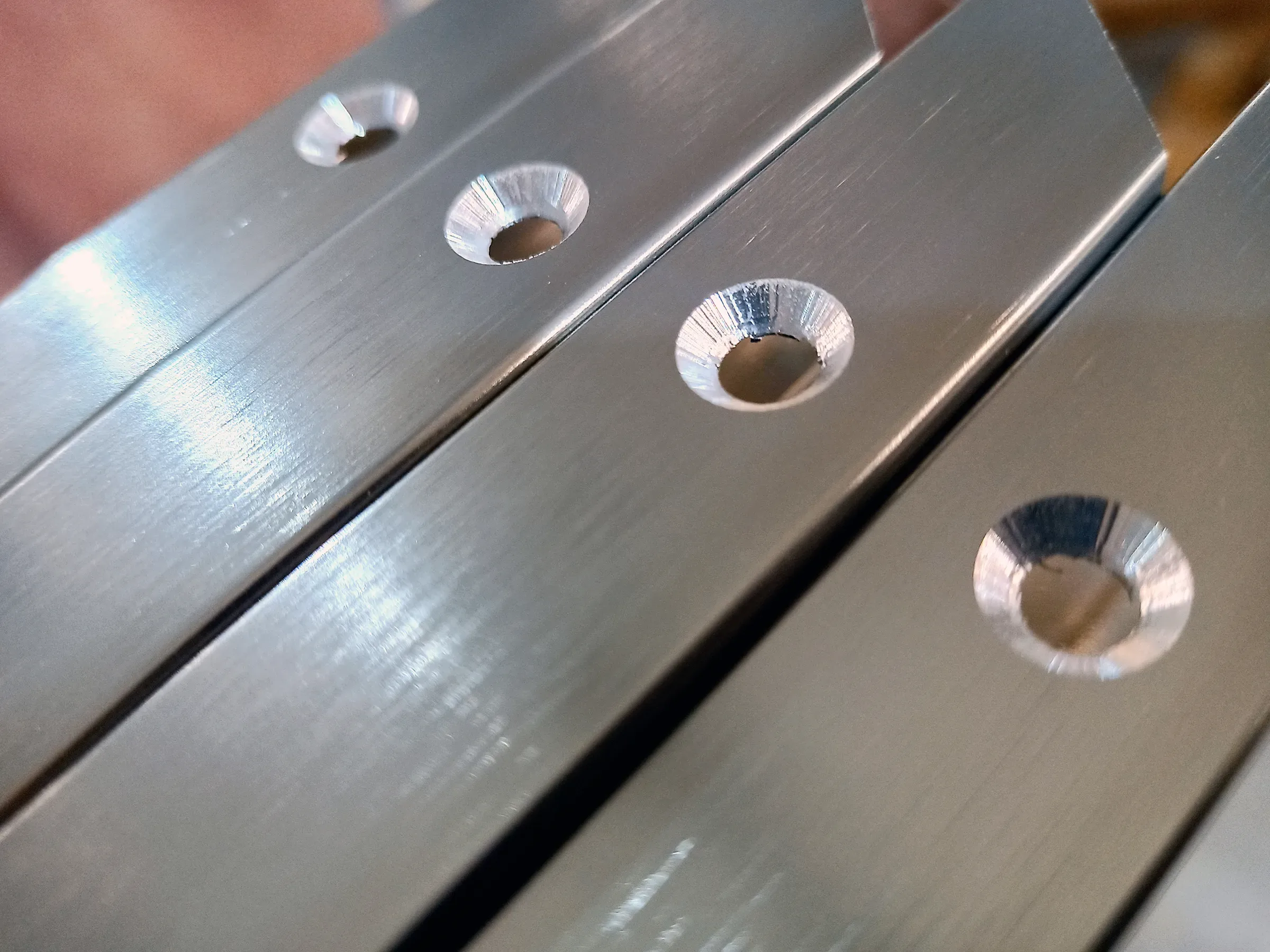

A hole in the aluminum metal made with chamfer or countersink on aluminum profile

When a countersink gives the best fit
Countersinks are the go-to choice for applications requiring a perfectly flat surface. They are designed specifically for flat-head screws, where the conical head must sit level with or slightly below the material surface to prevent snagging. This is common in aerospace, cabinetry, and consumer electronics where aesthetics and aerodynamics matter.
Beyond aesthetics, countersinking is often used for stacking plates where a protruding head would prevent a tight fit. However, this process often leaves sharp edges at the rim of the hole. Proper deburring is therefore essential after machining to ensure a clean finish, and to prevent stress risers that could lead to material fatigue or injury. Trust the quality of Protolabs Network for precision-machined holes that meet your exact tolerance requirements.
