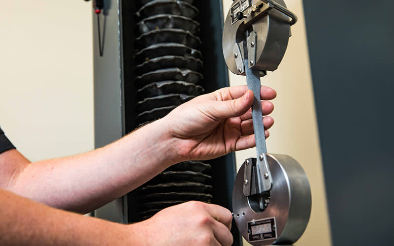

Ductility is commonly measured using a tensile test, where a material specimen is pulled until it fractures. Engineers typically quantify material ductility using two values:
Percent elongation: how much the material length increases before fracture
Reduction of area: how much the cross-section shrinks at the fracture point
Higher values generally indicate greater ductility.
During a tensile test, ductile materials typically exhibit necking, where the cross-section of the specimen begins to locally reduce before fracture. This localized plastic deformation is an indicator of ductile behavior.
How to calculate ductility
Percent elongation = (Lf - L0) / L0 × 100
L0 = original length of the specimen
Lf = final length after fracture

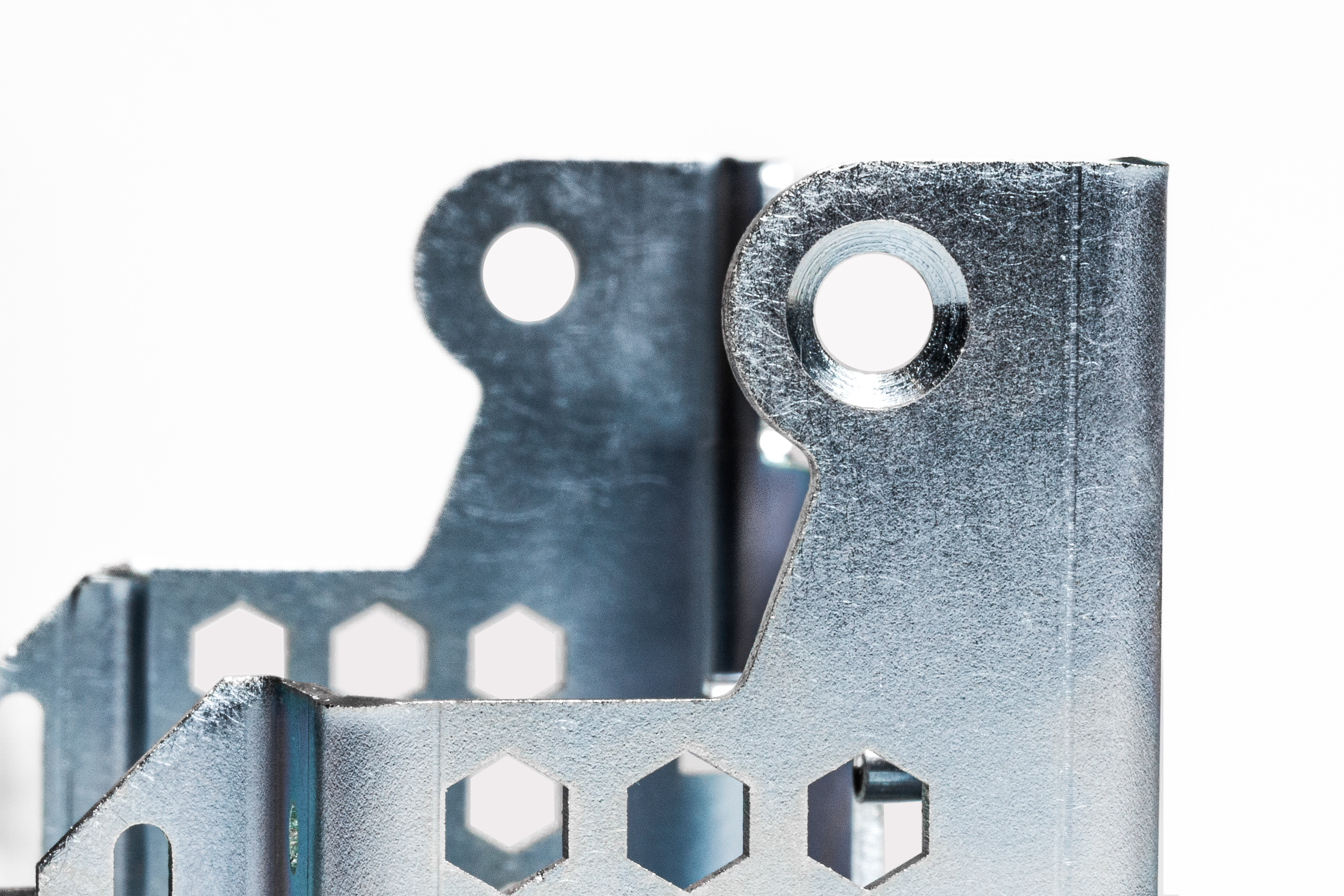

Metal forming
Manufacturing processes such as sheet metal forming require materials with enough ductility to change shape without cracking. Learn more about sheet metal fabrication in our design guide.
