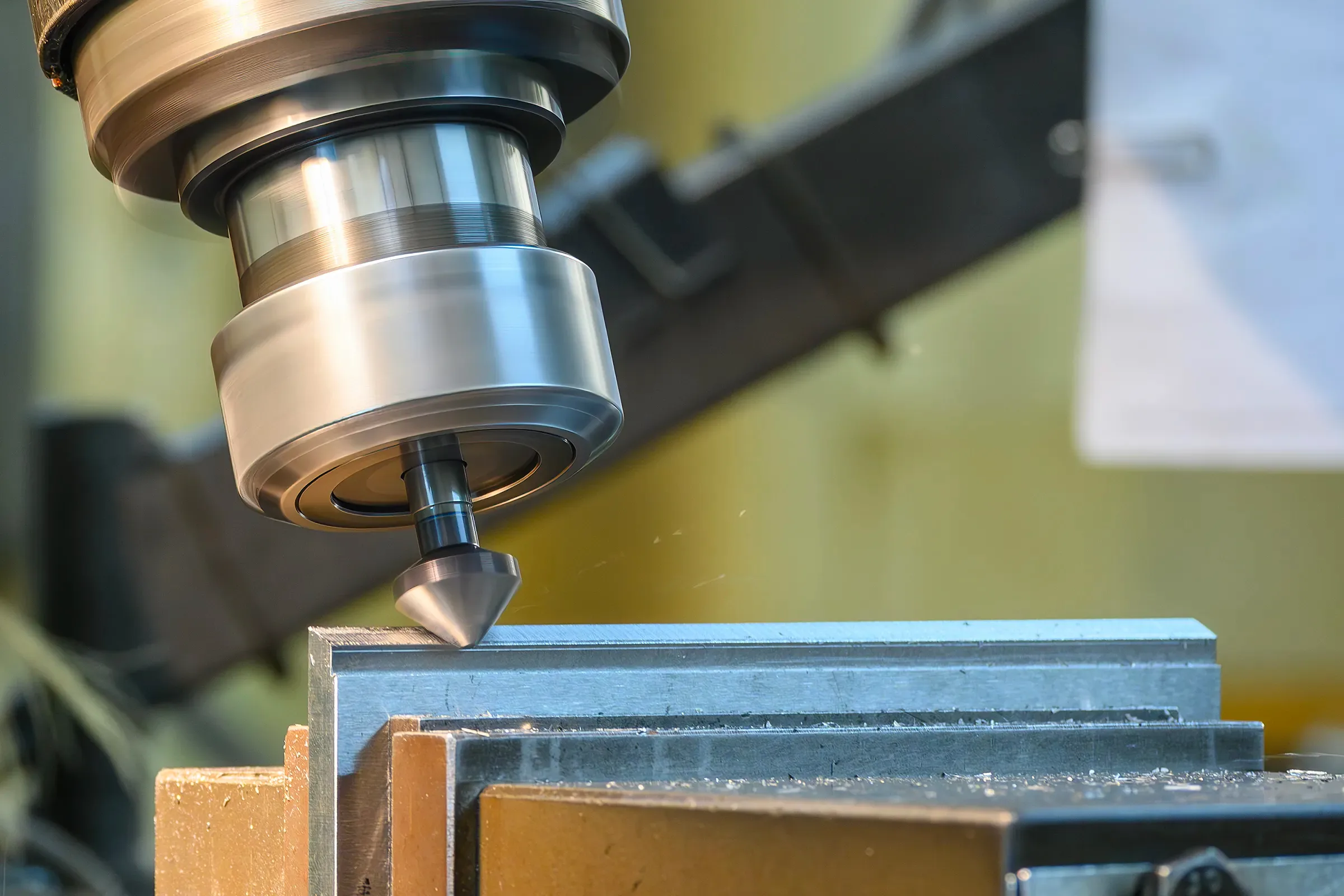

CNC milling, edge preparation
Plate beveling machines for consistent angles
Stationary plate beveling machines are designed for high-volume production, where angle accuracy is important. Unlike manual tools, these automated systems maintain a consistent degree across long spans of metal. This ensures repeatability for large-scale projects.
High throughput is achieved through motorized feeding systems that process heavy plates with minimal operator intervention. Examples include rotary shear bevelers for rapid edge prep and milling-style machines for precision J-grooves. By integrating automation, websites drastically reduce lead times while meeting the tight tolerances required for infrastructure.
Advanced milling-style plate machines can handle high-tensile steels and stainless alloys without changing the material properties. They utilize replaceable carbide inserts to produce a mirror-like surface finish, which is often required for nuclear or pressure vessel applications. This eliminates the secondary cleaning steps typically required following thermal cutting or manual grinding.
