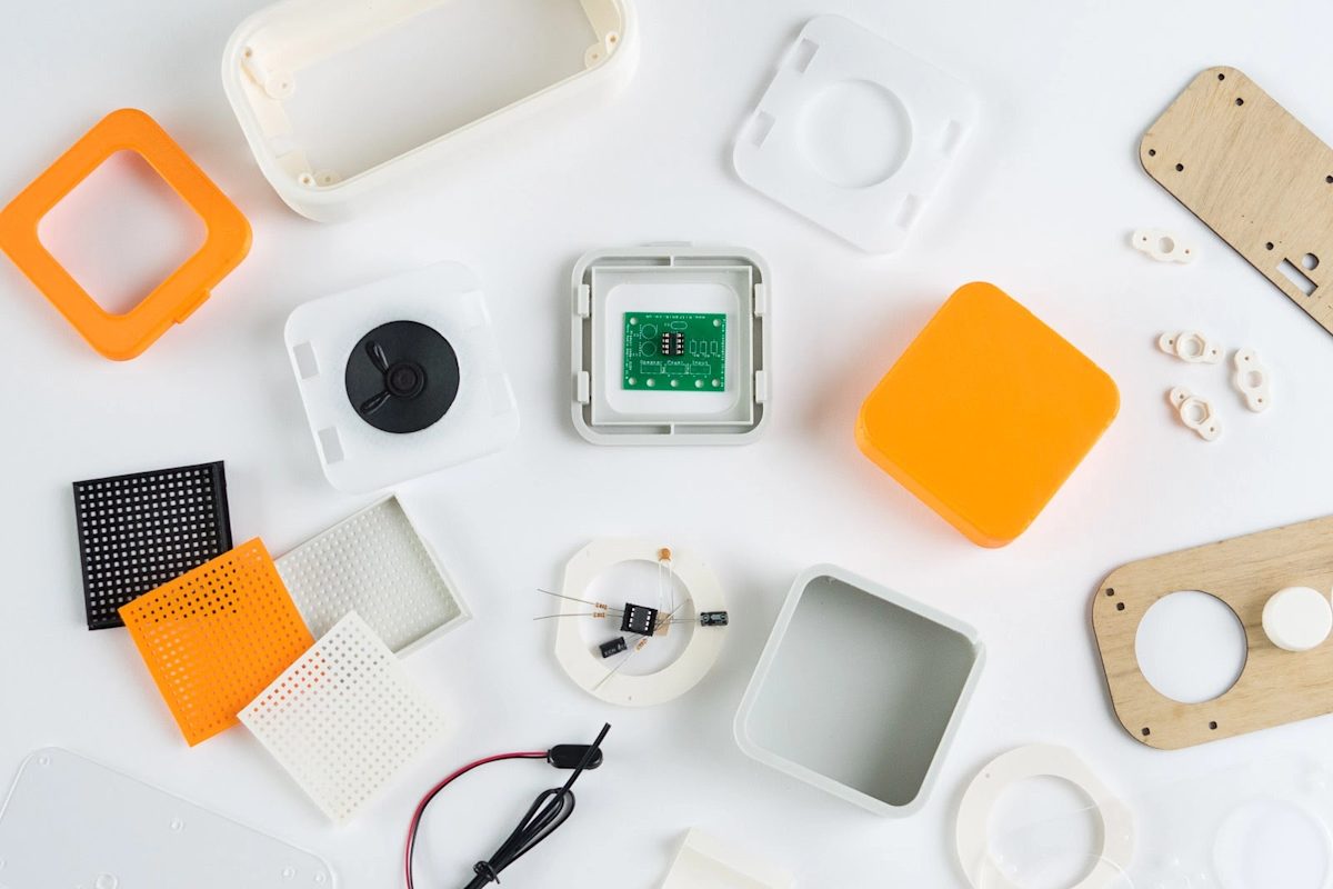

Dreaming up a design for a product is one thing. Getting it made is something else entirely. In this section, we cover how to transform a napkin drawing (or a fully-fledged CAD file and technical drawing, to be fair) into a physical object.
The most cost-efficient technologies for manufacturing your initial prototypes are prototyping FDM, prototyping SLA (both 3D printing processes) and sheet metal fabrication.
Highlighting cost, prototyping FDM is the cheapest way to produce proof of concept components. FDM is ideal in most cases if you want to see a basic physical manifestation of your product in the real world. However, it’s not ideal if you care about surface finishes or need moving parts.
Prototyping SLA is a bit more geometrically flexible than FDM and it comes at a similar price point for smaller batches of prototypes. SLA is good at producing organic shapes, and designs that work well with SLA tend to scale to injection molding.
Both of these 3D printing technologies work really well for producing plastic models that not only give you a clearer picture of what the product may look like several iterations from now, but also provide your sales teams something to show early clients. How you use the initial prototype is up to you, but it’s good to remember that you can take the first prints out of the R&D labs and put them into clients’ hands.
Choosing between FDM and SLA comes down to what kinds of geometries you’re going for, as both will net a cost-effective price tag. Definitely avoid metal 3D printing (DMLS), as it’s only really good at making parts that can’t be made any other way. So you’ll struggle when it comes time to start machining or molding designs previously produced by DMLS.
Producing initial prototypes with sheet metal is a whole different story. With sheet metal, the technology doesn’t change drastically from prototyping to much higher volumes of production. The machines begin to get more complex the closer your design gets to getting into the hands of end-users and customers, but it’s not like going from FDM to SLS (selective laser sintering) or MJF (multi jet fusion), which are worlds apart.
One way to ensure that initial prototyping costs aren’t astronomical is to avoid setting up automated pressing and bending. There’s not much of a reason to do this before the production phase.
