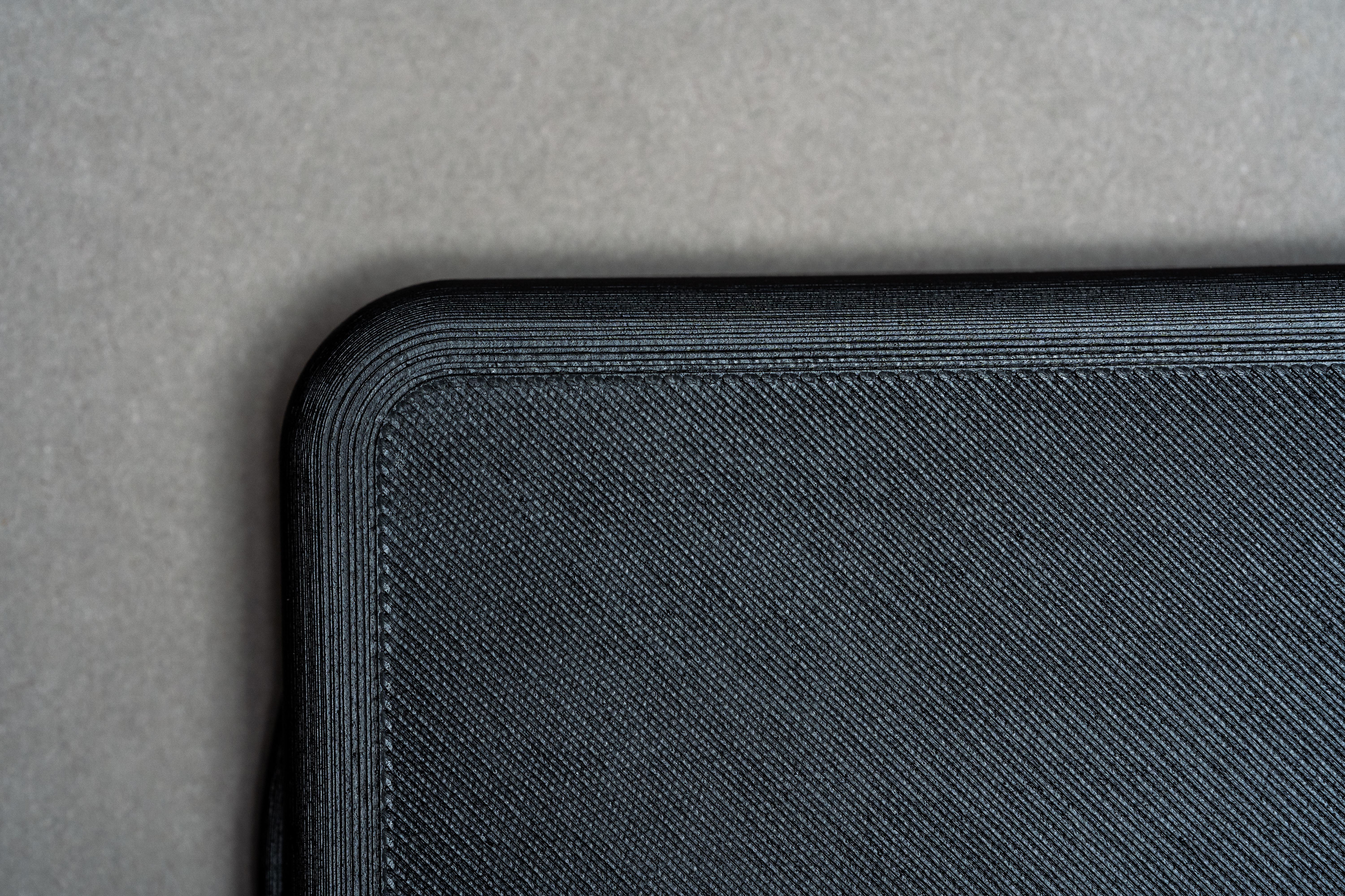

Does 3D printing or CNC machining offer better dimensional accuracy?
If dimensional accuracy is a top priority, CNC machining generally outperforms 3D printing. CNC offers high precision, excellent repeatability, and tight tolerances across a wide range of part sizes—from micro-scale components to large structural parts. While CNC-machined internal corners typically have a radius due to tool geometry, external features can be sharp and machined to very thin profiles with high accuracy.
3D printing accuracy, on the other hand, varies depending on the technology and machine used. Industrial-grade additive manufacturing systems (such as SLA, SLS, or DMLS) can achieve excellent tolerances, but they generally don’t match the precision of CNC machining. For parts with tight tolerances or critical dimensions, a common approach is to oversize the printed areas and post-process them using CNC machining.
Other accuracy considerations for 3D printing include:
  • Surface finish often includes visible layer lines, especially on curved surfaces or angled walls.
  • Build volume constraints limit the maximum part size, as many 3D printers require controlled environments to maintain dimensional stability.
In short, CNC machining is the better choice when tight tolerances and smooth surface finishes are essential. However, 3D printing can still be a strong contender for less dimensionally critical features or hybrid workflows.

FDM 3D printers can produce low-cost prototypes for electronics enclosures
When developing a new consumer electronics product, creating functional prototypes—especially for plastic enclosures—is a critical part of the product development cycle. At this stage, speed and affordability are often more important than long-term durability.
