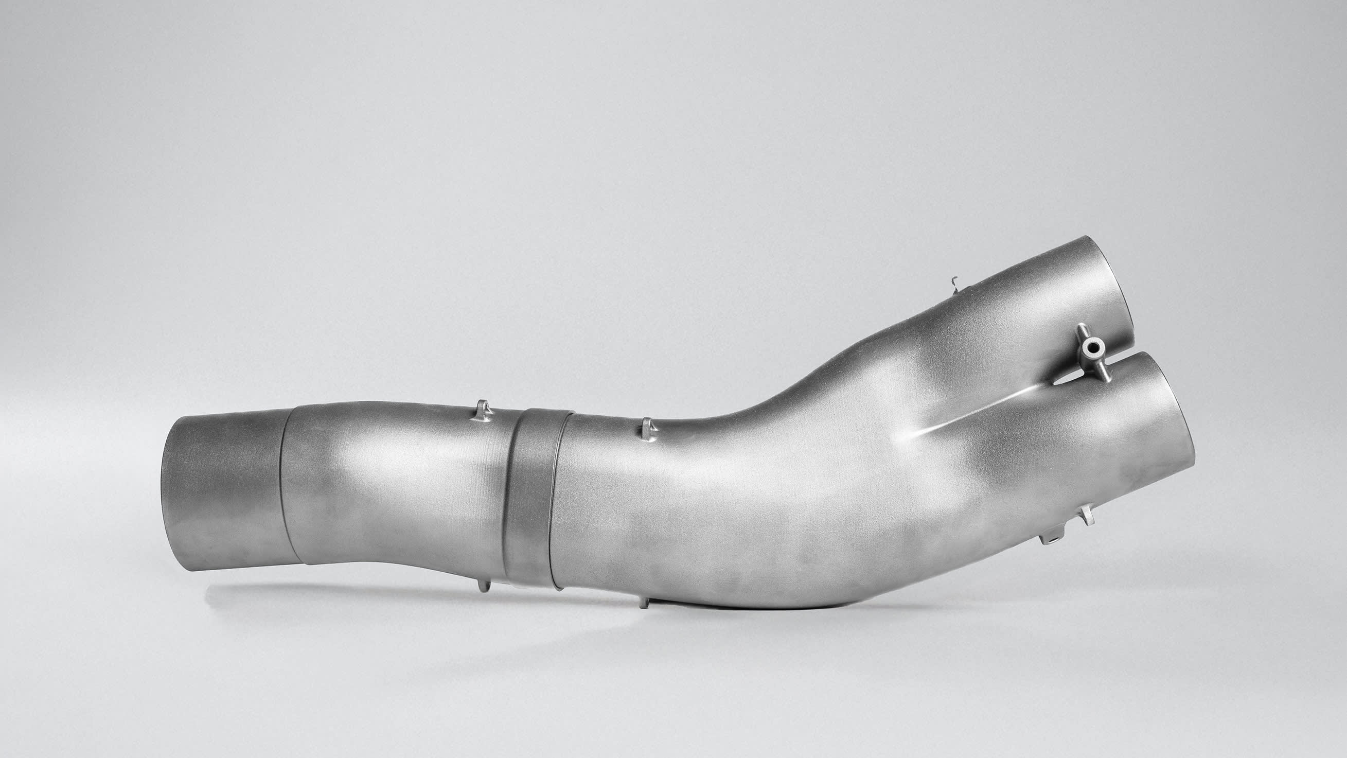

Example of a smooth machined part in titanium
