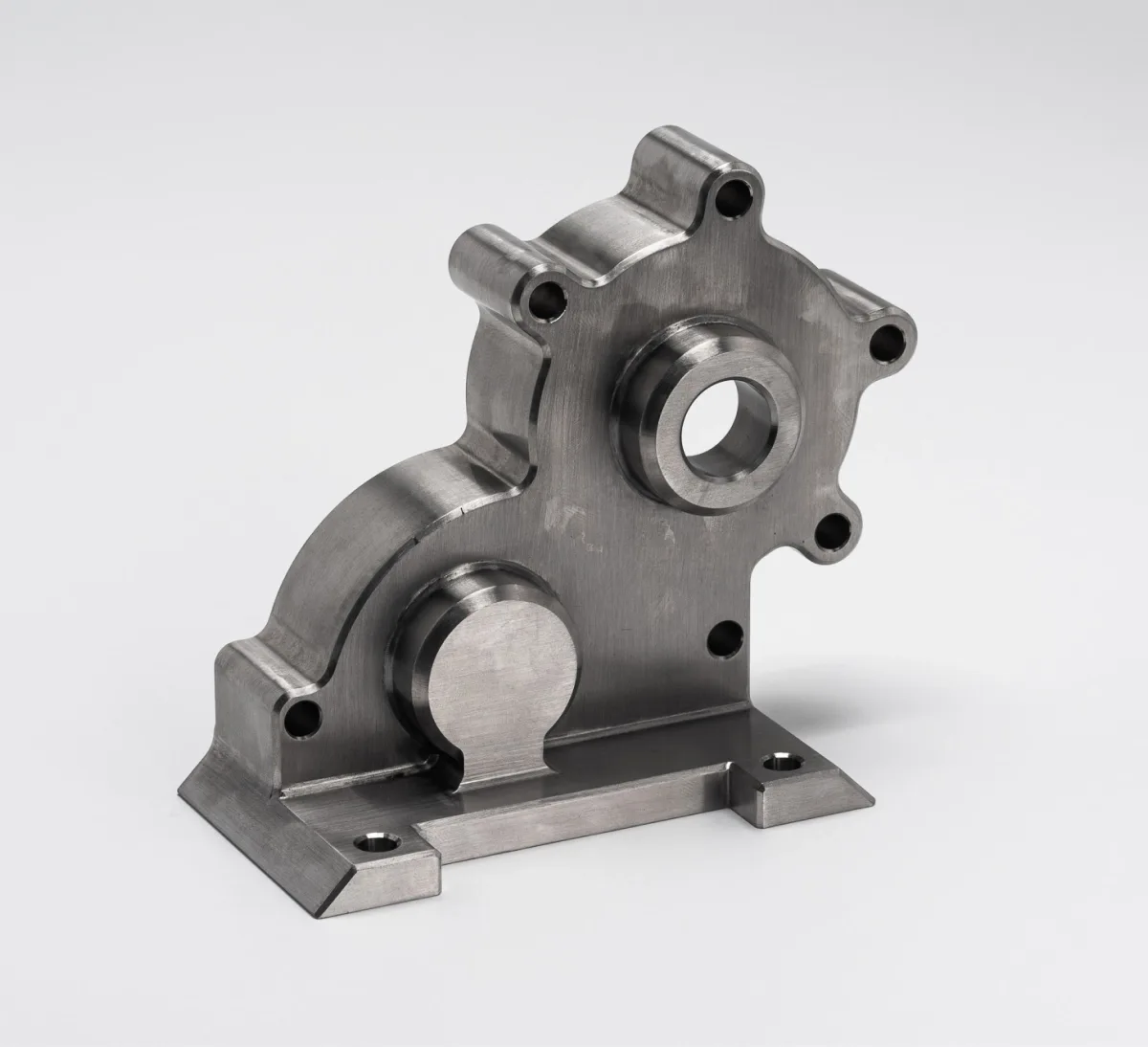

Photo of a stainless steel part in brushed surface finish
