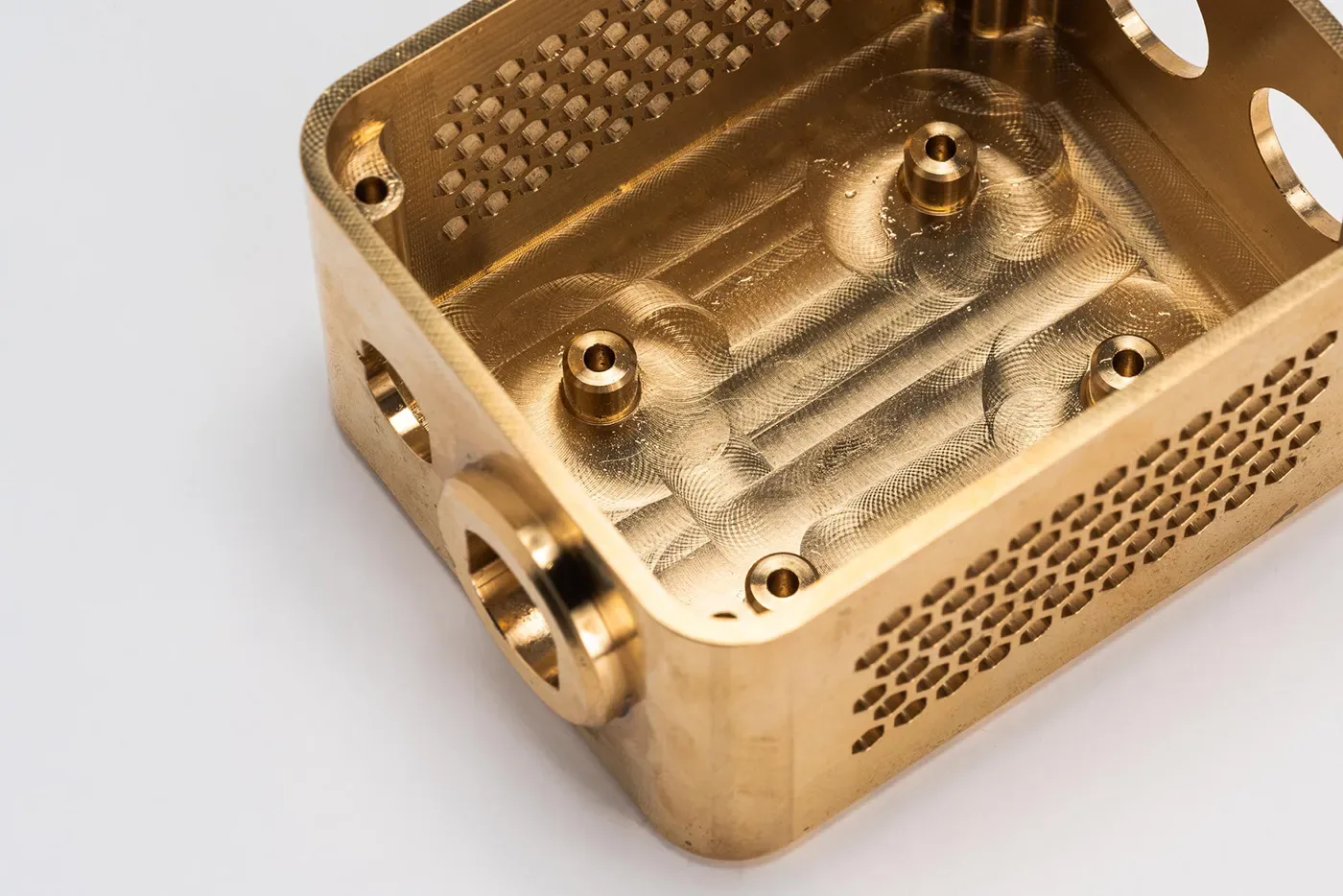

What is brass?
Brass is an alloy of copper and zinc. It cuts cleanly at high speed, holds tight tolerances, causes little tool wear and comes off the machine with a smooth, bright finish. Its properties depend on the zinc content and on small additions such as lead, so brass comes in a range of grades, each suited to a slightly different job.
Brass CNC Machined Part
