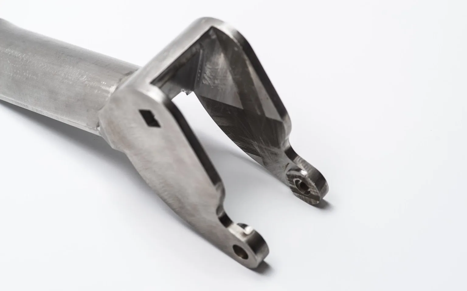

42CrMoS4 (material number 1.7227, EN 10083-3) is a chromium-molybdenum alloy steel designed for high-volume CNC production. It is chemically almost identical to 42CrMo4 (1.7225), with one key difference: a sulfur content of 0.020–0.040%, which improves machinability.
This single element is why production engineers specify it over the standard grade. The "S" in the designation determines how the steel cuts, how long inserts last, and how profitable a production run is.
Both grades conform to EN 10083-3. For sourcing purposes, 42CrMoS4 maps closely to AISI 4140. Confirm the sulfur specification on the datasheet before substituting.
What is 42CrMoS4 alloy steel
Chromium (0.90–1.20%) and molybdenum (0.15–0.30%) provide the alloy's core mechanical properties. Chromium increases hardenability, enabling the steel to form martensite throughout sections up to approximately 60 mm (2.4 in.) in diameter during quenching. Molybdenum refines the grain structure, improves tempering resistance, and enhances toughness under repeated dynamic loading.
Sulfur reacts with the manganese already present in the alloy to form manganese sulfide (MnS) inclusions. In the cutting zone, these inclusions fracture ahead of the cutting edge, producing shorter, more manageable chips. This reduces heat transfer to the cutting insert and can extend tool life while maintaining high machining speeds, depending on the application.
