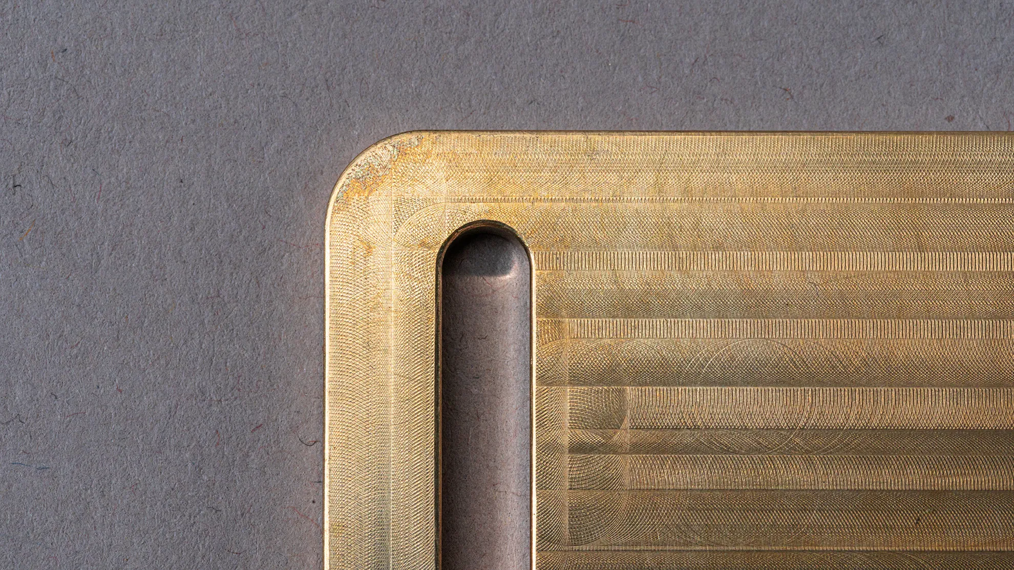

Bronze material cnc machining

Fabrication and machining: from cold rolling to precision milling
CuSn8 achieves its highest mechanical properties through cold working and is typically supplied as sheet, strip, or rod in a range of tempers, such as R450, R560, and R690.
From a machining perspective, CuSn8 is generally considered to have moderate-to-good machinability. However, its toughness and tendency to work hard require a carefully optimized tooling strategy. Engineers should specify sub-micron grain carbide tools, ideally with chromium nitride (CrN) or TiB₂ coatings, to reduce material adhesion at the cutting edge.
High-pressure flood coolant is also important during milling operations to improve chip evacuation and minimize localized heat buildup, which can lead to dimensional inaccuracies. Compared to free-machining brass, lower cutting speeds are typically required to maintain acceptable tool life.
