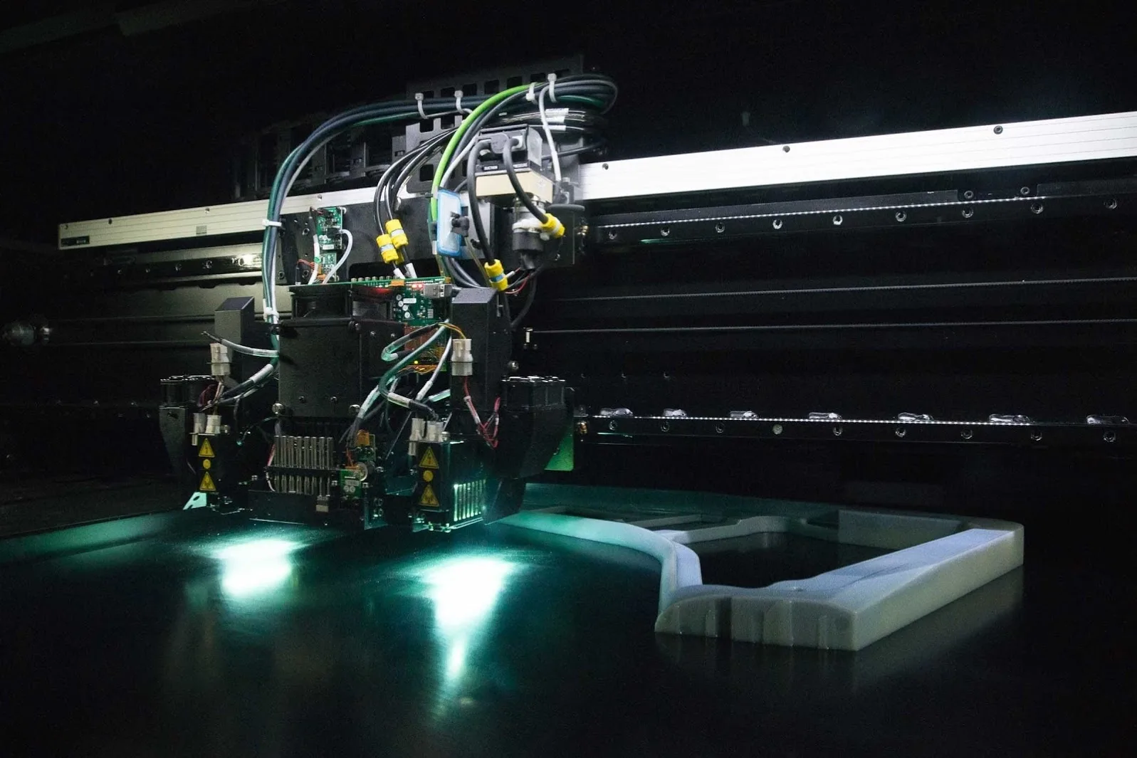

3DP 101 - A Material Jetting 3D printer in action
