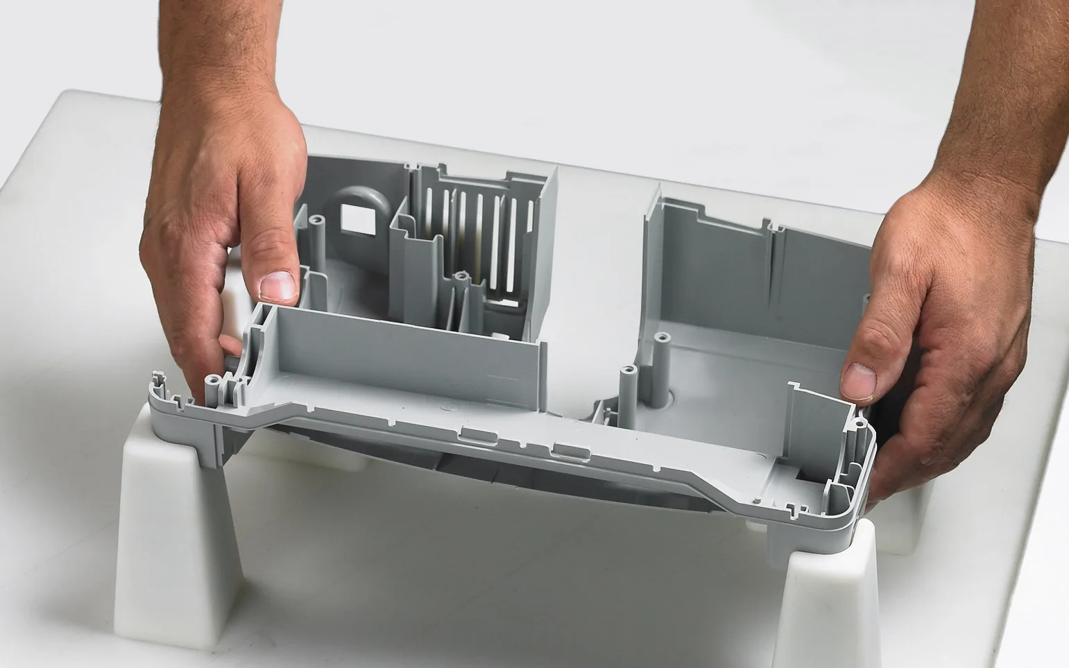

3D Printing for Grips, Jigs and Fixtures
Both tools function as workholding devices, but their primary purposes differ. A jig guides the cutting tool to a specific location, whereas a fixture secures the workpiece in a fixed position relative to the machine. Distinguishing between these two remains vital for optimizing setup times and ensuring part interchangeability.

3D printing vs. CNC machining for jigs and fixtures
The choice of manufacturing process depends entirely on the mechanical stress the tool will endure. 3D printing, specifically FDM or SLS, serves as the optimal choice for lightweight, ergonomic hand-held jigs or non-marring fixtures. Plastics such as Nylon or TPU protect finished surfaces and allow for complex, organic shapes that conform perfectly to a part's geometry.
For high-force applications like heavy milling or high-speed drilling, CNC machining remains essential for metal-on-metal durability. Steel or aluminum fixtures provide the rigidity and wear resistance required to withstand thousands of cycles. Unlike printed polymers, machined metal aids maintain their structural integrity even under the intense clamping pressures and heat generated by industrial cutting processes.
