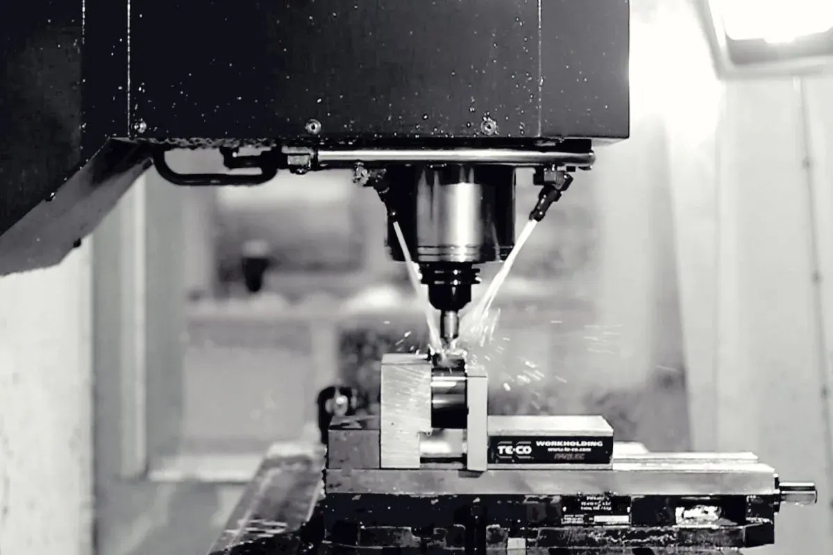

Basics of 3 axis and 5 axis machine movement
At the core of CNC machining lies the coordinate system that defines tool movement. In a 3-axis setup, the cutting tool moves along the linear X, Y, and Z axes. This configuration is ideal for parts where you only need to reach a single face at a time.
The workpiece remains stationary on the machine bed, limiting the tool to a vertical or horizontal approach. While efficient for simple geometries, it requires manual intervention for any features located on the sides or underside of the part.
5-axis machining introduces two additional rotary axes, typically referred to as the A-axis and B-axis. These axes allow the tool or the table to tilt and rotate during the cutting process.
In a trunnion-style machine, the table rotates, whereas in a swivel-head machine, the spindle itself tilts. These complex kinematics enable the spindle to approach the part from virtually any angle. This maintains optimal tool engagement, ensures a constant chip load, and eliminates the need for multiple manual setups.
