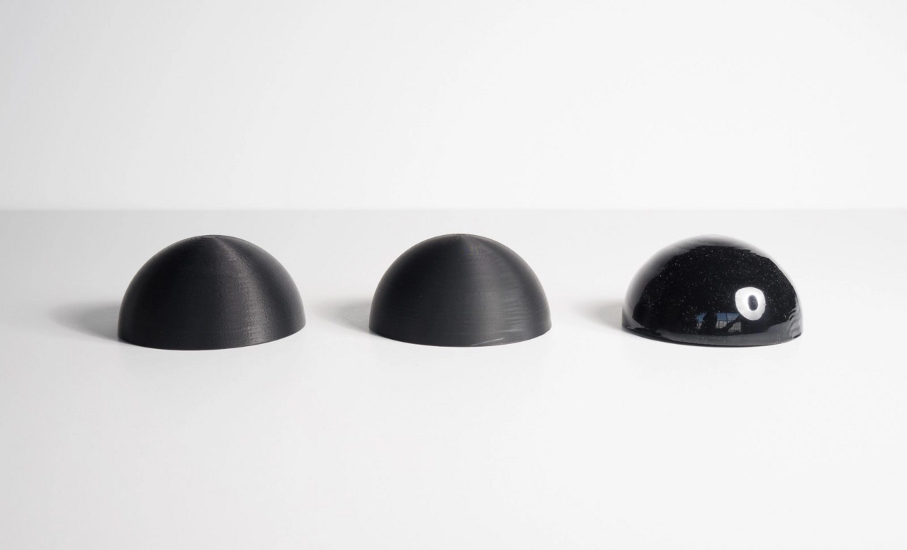

Sanding 3D prints: techniques for a smooth 3D print
Achieving smooth 3D prints requires a structured approach. Sanding should always be done progressively, using finer abrasives at each stage.
The 5-step smoothing process
1. Support removal and preparation
Before sanding, remove all supports and surface defects.
  • Use flush cutters or pliers
  • Trim excess material
  • Clean edges with a hobby knife
Proper preparation ensures a consistent surface and prevents defects from carrying through the sanding process. Designing parts to minimize supports can also improve surface quality. Learn more about this in our guide to design for 3D printing.
2. Progressive sanding techniques
Progressive sanding is essential for achieving smooth 3D prints. Typical grit sequence:
  • 120–220 grit → removes layer lines
  • 320–400 grit → makes the surface smooth
  • 600–800 grit → refines the surface finish
  • 1000+ grit → final polishing
Avoid skipping grits, as this can leave scratches that are difficult to remove.

4. Filling, priming and final coating
Even after sanding, small imperfections may remain. To achieve smooth 3D prints:
  • Apply filler or filler primer
  • Sand again with fine grit
  • Apply primer for uniformity
  • Finish with paint or coating
Priming helps to reveal remaining defects and improves final surface quality.
