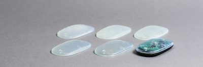

An electronic enclosure with a clear SLA top cover post-processed to a range of different finishes

Basic support removal
Process: The support structure is broken off or cut from the model leaving a bumpy surface on the surfaces in contact with support material. If a high quality surface finish is required adding extra material (at least 0.1 mm) to be sanded afterwards allows for better dimensional accuracy.
Pros
Gives the customer complete control over the finish.
For critical vertical hole diameters drilling after printing is recommended if high accuracy is desirable.
Highest accuracy as overall geometry is not altered
Cons
Not aesthetically pleasing
High level of skill required to achieve a clean finish
Finish ☆ ☆ ☆ ☆ ☆
Tolerances ★ ★ ★ ☆ ☆
Speed ★ ★ ★ ★ ★
Suitable for All SLA resins
Sanded support nibs
Process: Only the small support nibs are sanded off. This process is suited for flat surfaces where it is easy to judge the surface is flat. Because the surface is only sanded at the support nibs the overall geometry of the parts is generally unaffected.
