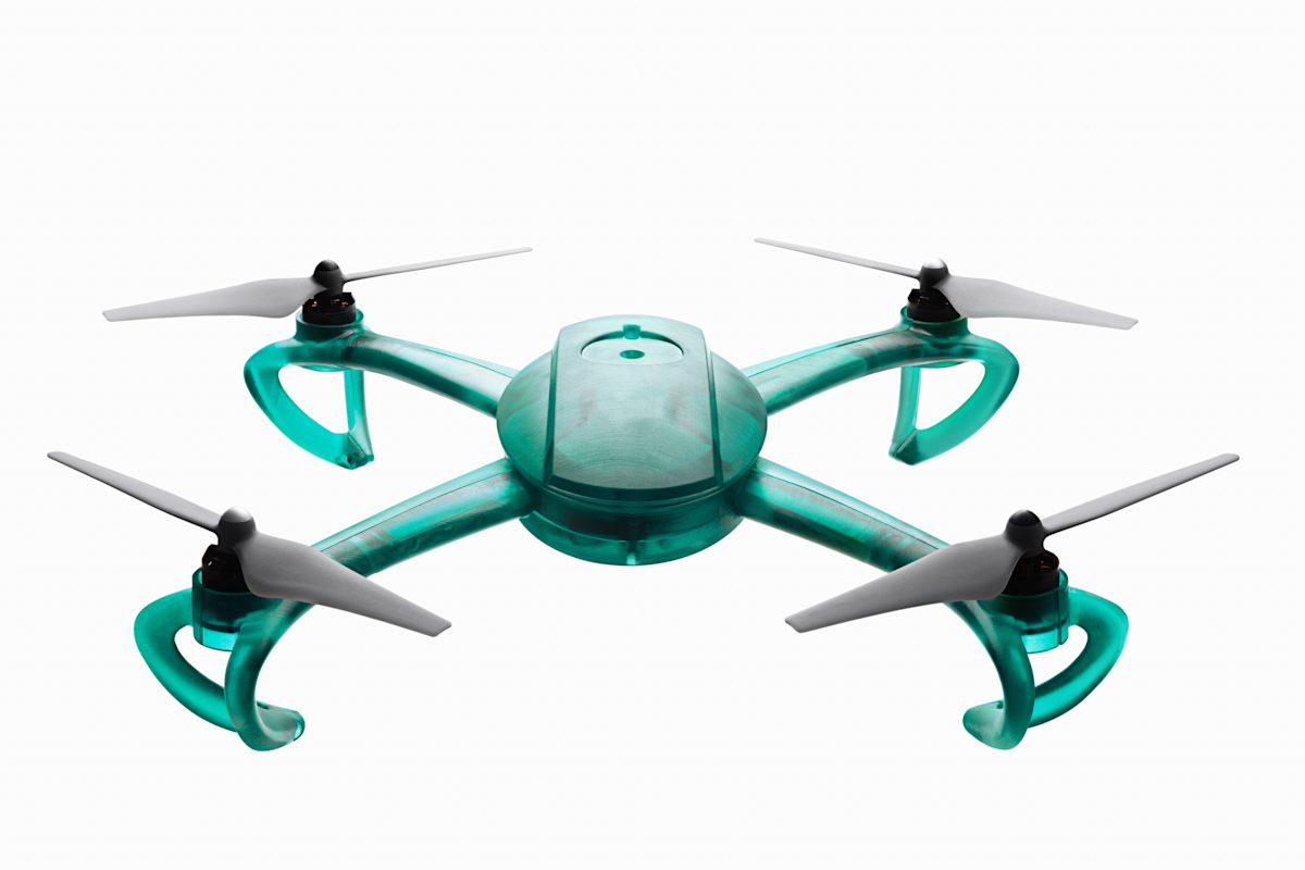

Tough resin (ABS-like)
Similar to ABS, tough resin was developed for applications requiring materials that can withstand high stress and strain. Parts printed in tough resin have tensile strength (55.7 MPa) and modulus of elasticity (2.7 GPa) comparable to ABS.
This material will produce sturdy, shatter-resistant parts and functional prototypes, such as enclosures with snap-fit joints, or rugged prototypes.
Tough resin is ideal for functional prototypes and mechanical assemblies.
Pros
High stiffness
Excellent resistance to cyclic loads
Cons
Not suitable for parts with thin walls (recommended minimum wall thickness of 1 mm)
Low heat deflection temperature
Relatively brittle (low elongation at break)
A quadcopter prototype 3D printed with SLA in Tough (ABS-like) resin.
