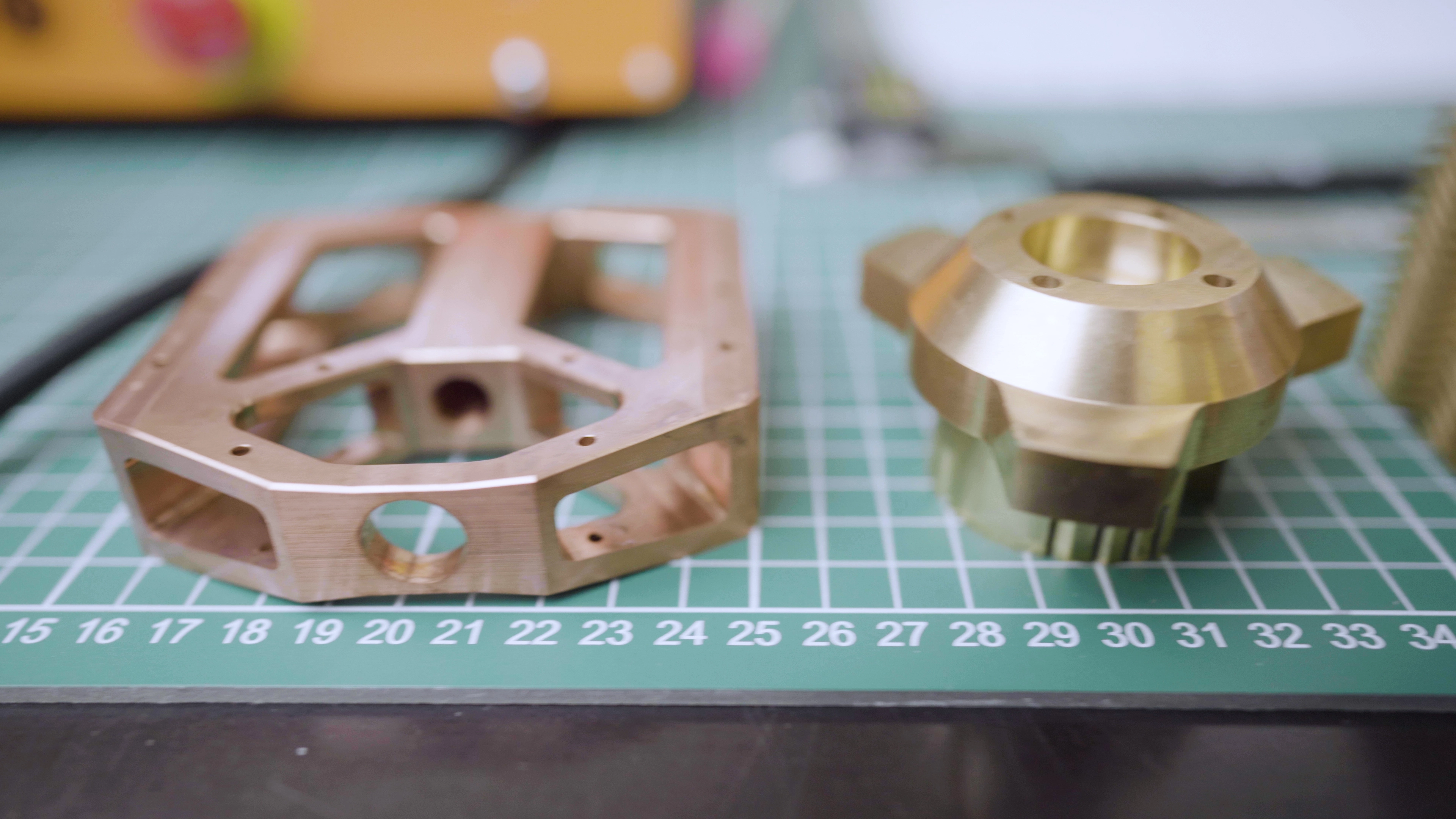

Bronze material cnc machining
Heavy-duty applications for CuSn8 tin bronze
Analyze the mechanical performance of CuSn8. From hydraulic cylinders to marine hardware, see how this 8% tin alloy handles stress.
