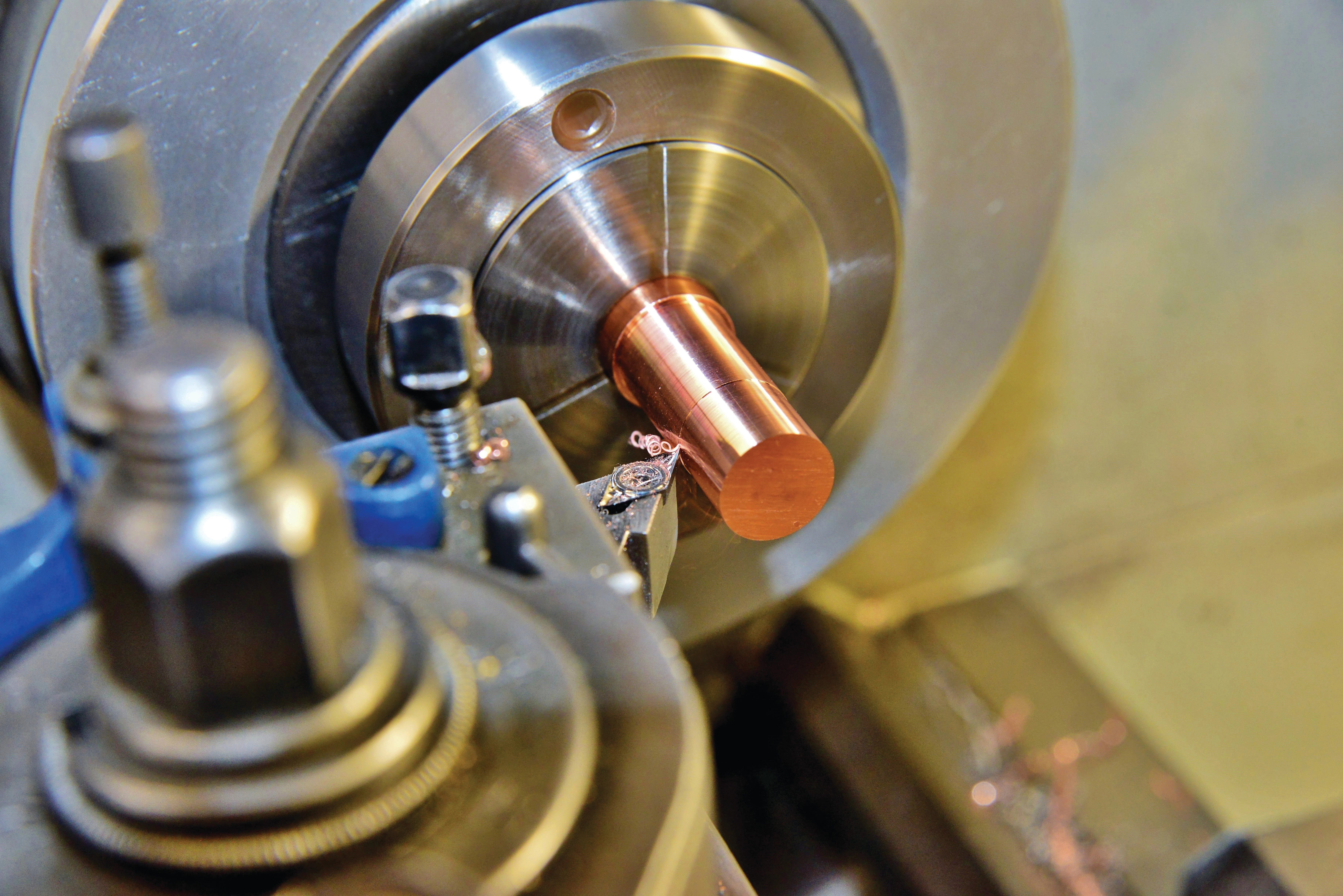

CNC lathe machine in action.

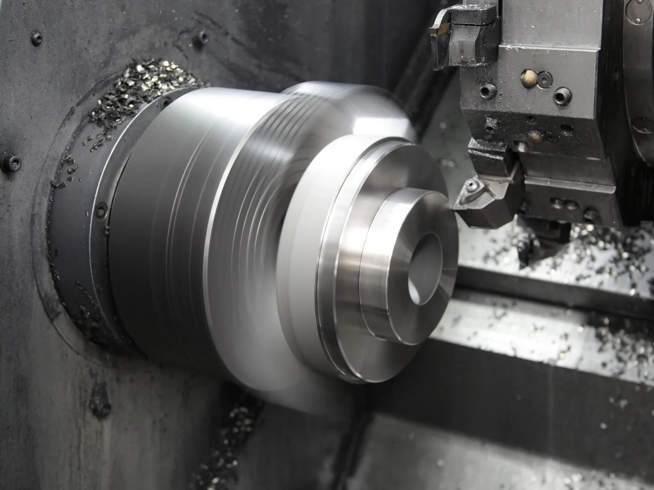

In the CNC turning process, the workpiece spins around an axis and the machine tool moves in a linear action. This enables cylindrical parts to be produced, as well as operations such as cutting, drilling, turning and threading. It also uses an SPTT or a single-point turning tool which is in direct contact with the workpiece throughout the operation.

The transformation of raw stock into a finished component through CNC turning is a synchronized process of mechanical stability and digital precision. It begins with the workpiece setup, where the raw material is securely mounted into the machine’s chuck or collet. This connection is essential as it must hold the material completely centered while it rotates at high speeds, providing the rigid foundation necessary for micron-level accuracy.
The tool selection and CNC programming phase works in tandem with the physical setup. Engineers select specific cutting tools, such as grooving, threading, or drilling tools, and load these into the machine’s turret. Concurrently, the digital design is translated into a CNC program. This code acts as the machine's ‘brain’, containing precise instructions for every tool movement, spindle speed, and feed rate required to execute the design.
The process culminates in the machining operations. As the spindle spins the workpiece, the machine executes the programmed paths, moving the stationary cutting tools along their respective axes. With surgical precision, the tools shave away excess material, gradually revealing the final dimensions and features of the part. This automated cycle continues until the raw material is fully transformed into a high-fidelity, finished component.
