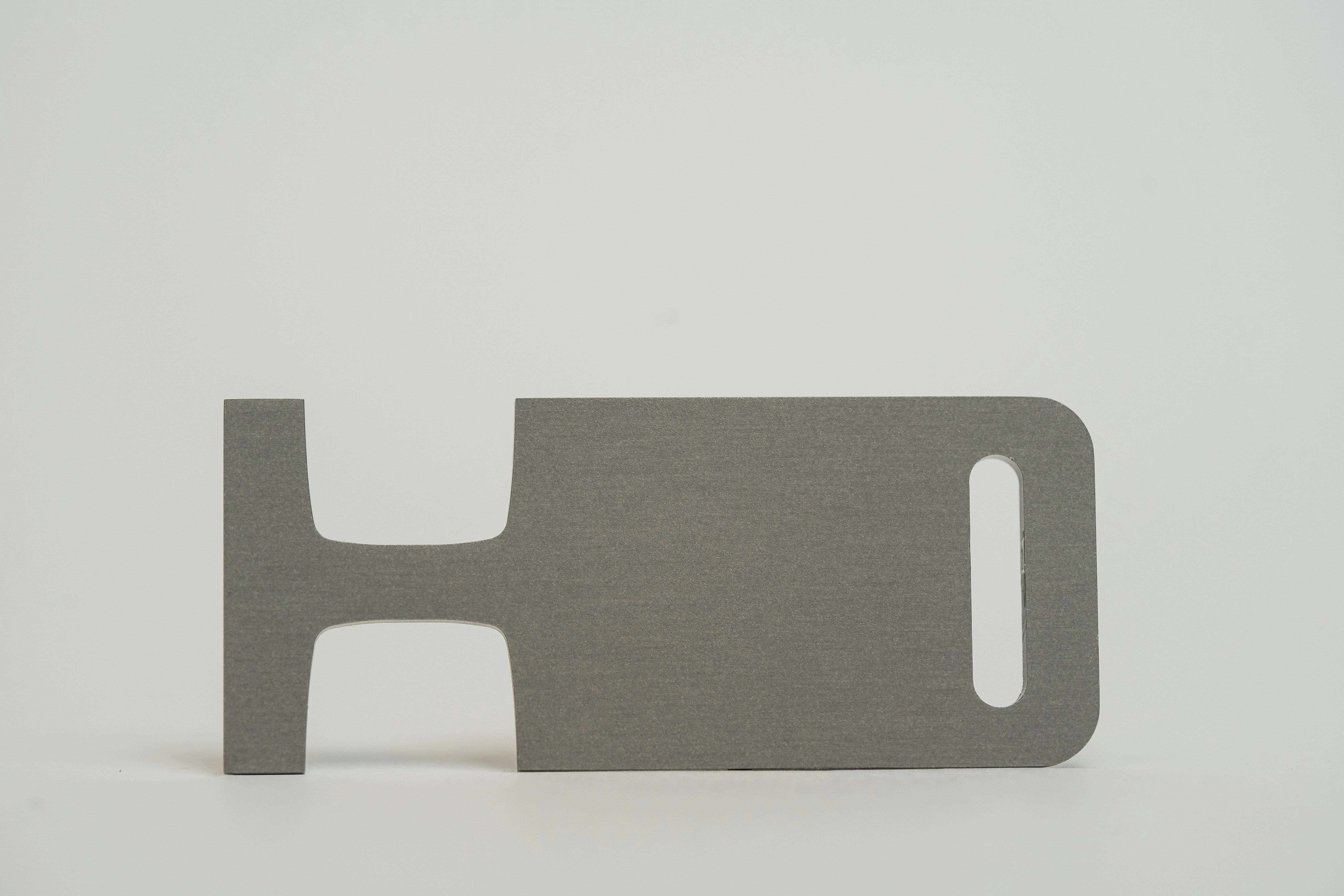

What is bead blasting?
Bead blasting is a surface treatment process that involves using compressed air to shoot tiny spherical particles, called beads, at a surface with high pressure. The goal of bead blasting is to clean or even a part’s surface to improve its functionality or cosmetic quality after CNC machining.
How does bead blasting work?
The bead blasting process works by using the impact of beads to remove contaminants such as rust, paint, scale or corrosion from a surface. The result is a surface that is uniform, smooth – often with a matte or satin texture – and clean, which makes it easier to apply a new finish or coating to the part.
