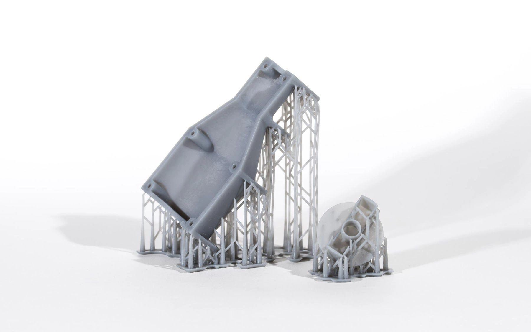

Cosmetic side dictation for SLA
Here’s how you can dictate a cosmetic side for SLA:
  1. Upload your part and select an SLA material (for example, clear resin).
  2. In the part description area, click on ‘Select cosmetic side’.
  3. In the 3D file viewer, select the side that should NOT be in contact with support structures.
  4. Optionally, you can add additional comments about the part orientation.
  5. Click ‘Confirm’ to save your preference.
The green overlay in the 3D viewer indicates the areas that will have the best possible finish. In SLA, support structures are always required and the areas that will come in contact with them will have small blemishes that need to post-processed manually. This feature helps you dictate easily which side is most critical for your application.
Our Manufacturing Partners will receive your selection as a soft requirement, meaning that they will protect the areas you have indicated, but they may have to change the orientation slightly due to technical limitations.
Learn more about supports in SLA in our Knowledge Base article
