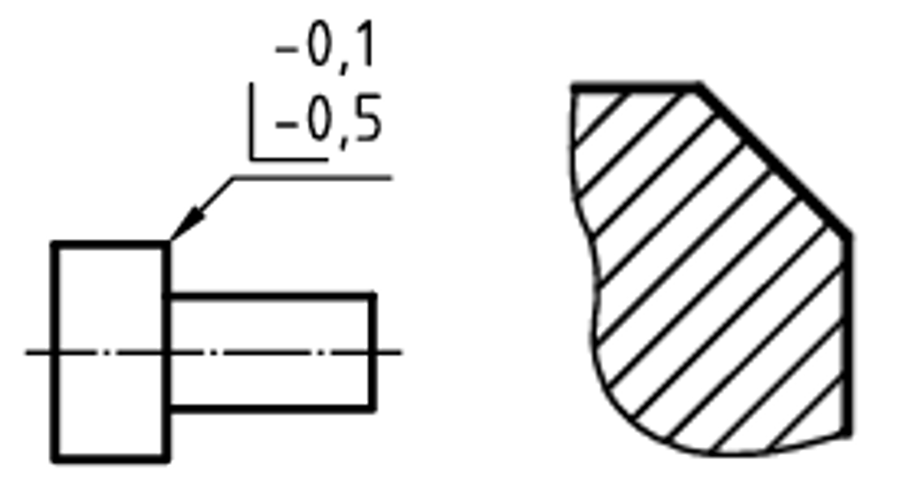

Our standard requirements for edge breaking and deburring are as follows:
  • Deburring comes as a standard with all finishes
  • Standard: Deburring + Break Sharp Edges (Chamfer)
  • No secondary burrs allowed
  • Chamfer size: -0,1/-0,5 mm*
  • Internal threads, bores and blind holes will also be deburred
    with the aid of deburring brushes when need be.
  • Chamfers will be done during the machining steps as much as possible, to ensure a consistent look.
    When not possible, these can be done by hand with a regular hand deburring tool.
The image below is based on the ISO 13715 standard. For full details, please refer to the official ISO publication: www.iso.org
Chamfer size
