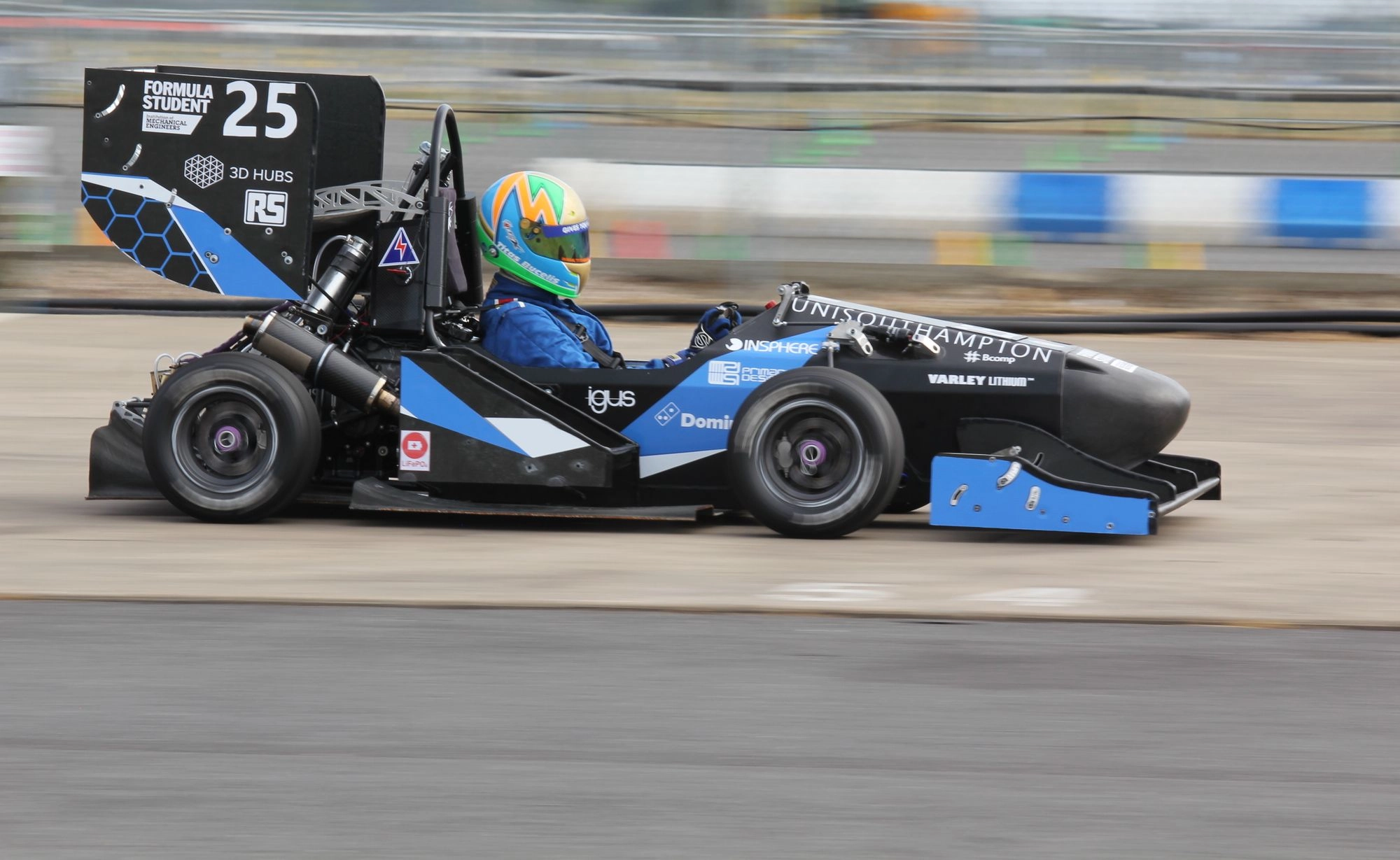

SUFST, founded in 2012, is a Formula Student team from Southampton, UK. Their first formula race car - the STAG O - was ready to compete in the Summer of 2013 and they have been racing every year since in national and international competitions.
Despite being young, the engineers of this team are highly ambitious and talented. Their senior members have years of Formula Student racing experience and a lot of hands-on knowledge gained by working for some of the biggest names in motorsport, like Red Bull Racing, McLaren and Force India.
Last year, the team managed to complete for the first time the Endurance Event of the Formula Student competition with their STAG V. The Endurance Event is a 22 km race that pushes the car to its limits and completing it is a huge achievement, as about 50% to 75% of all teams never make it.
