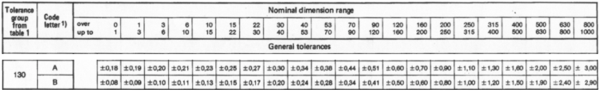

Standard tolerances are defined by DIN 16901-130 standard. This means the standard tolerance group is 130 for any material.
The table below defines the general tolerance for a given nominal dimension range.
![](http://images.ctfassets.net/q2hzfkp3j57e/4m8mCpnzQbAXtgzliWEYYF/f737cd4a2938c3b7198c280eb7354ff1/im-standard-tolerances.webp?w=853&q=70)
Code letter:
B refers to mold related dimensions, as shown on Fig. 1. These are the dimensions in the same part of the mold.
![](http://images.ctfassets.net/q2hzfkp3j57e/2wBAHwr2hUO7dlOj5YVwFO/196c10f3356b0cc50b7c4057971a423a/IM_mould-related_dimensions.webp?fm=jpg&w=1200&h=1200&q=82)
A refers to non-mold related dimensions, as shown on Fig. 2. These are the dimensions determined by the interaction of movable elements of the mold (for example wall thickness or bottom thickness, or any dimension determined by the shims or mold slides).
