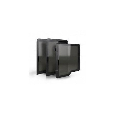

Do you have side panels? I printed larger prints in white Z-ABS but I have enclosed printer. Warp crack occur always between layers. Try looser infill and more supports (to insulate print). And cover frame holes if you haven’t yet.
I don’t have side panels. How exactly do those improve the quality of the print?

Frame holes I mean that huge front and side holes in printers frame:) You can even cover them with foil the way air can’t blow on the print inside. Top hole should be left open. Search web for the pictures of Zortrax equipped with side covers.
To be honest I don’t know how they improve print quality because I’ve never tried without them;)

Covering the “holes” allows for proper heat retention and restricts excess airflow from the printer’s surroundings. This prevents a temperature imbalance that can induce warping, especially with ABS. I’d highly recommend going through a 3rd party source for these parts since the Zortrax brand parts are quite expensive. I suppose you could always make your own as well.

Looks like covering the holes (side and front) worked - I used aluminum foil last night, and the print came out dramatically better.
Where can I purchase some of the third party parts? All I’ve seen are the ones on eBay that seem to be from the Zortrax retailer. They go for about $79. Are there other options available?

There are some other options available but not really much cheaper than $79.00.
I do not believe that you will be getting real Zortrax panels for $79.00 and if you are please let me know where they are available for $79.00.
The Zortrax Panels made by Zortrax are excellent but they usually go for $99.00.
They fit right in, no screws, no magnets to install.
Very easy to install. They stay on.
The Door keeps closed (build in magnet to keep door closed).
They work and look great.

I bought these covers from Octave Systems for $59 and they have worked for me for a year now. They are laser cut acrylic with 3D printed latches (included) that do not require tools to assemble. If you want the cheapest off the shelf solution this is the best and lowest price I’ve found.
Hey,
Man, you’ve got 3D printer, you can make your own covers yourself;) Print clips, lasercut 4mm acrylic and you would have them for less than $20 and in colour you like!
