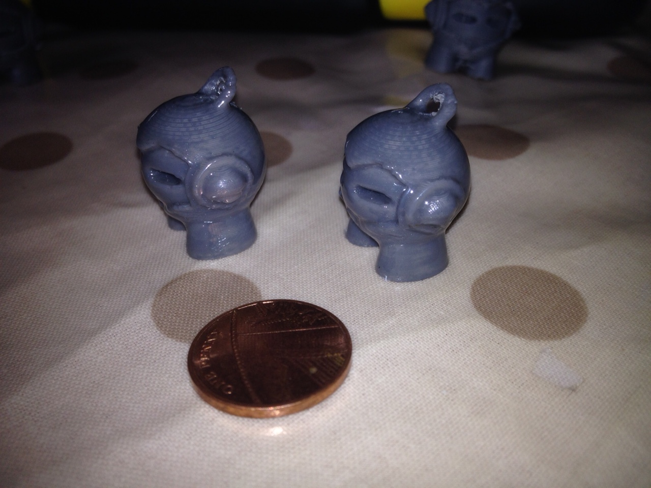

A bit like myself marvins abs and rear are not very toned when I try and print him, the upper half is all fine though, the legs are fine, I wondered if it might be a support issue, has anyone come across this before please. I’m also trying to print him in different areas of the plate to see if its a heat near the bottom thing, its ABS and on an up mini, any help appreciated. Thanks
up mini settings 0.2mm layers minimum fill and no support, cant configure many settings on the up mini. I did try treating them to an acetone vapour session to see if it made it look better, what do you think ?

I was seeing this very thing on my FFCP and played around with many different settings. The problem I noticed was warping. The previous layer warped up and interfered with the current layer and marvin’s butt just looked flat. I also noticed the same problem under the ears and, to some extent, in the eyes as well.
The changes I made that helped the most are as follows (listed from least improvement to greatest):
1. Slowed down the print speed.
2. decreased the print temp as much as possible.
3. installed an active cooling fan (I am not sure if this is an option on your machine).

The problem with the Up is the software was designed to work with support so it does a poor job with bridging because it doesn’t know to print a little faster/cooler when bridging. Your biggest issue here is being too hot for your filament. If you search the Up forums there is a software hack to allow you to lower the printing temp. Alternately, if you prefer a hardware solution you can build my hardware mod for under $10 http://www.thingiverse.com/thing:528396
Once you have a temp mod you can print with or without support just like it is Up genuine filament.
While you don’t have a temp mod having the fan door open (handle in the up position) will also help but usually I don’t like to print that way for ABS as it will make bigger things than Marvin warp. Also printing on Fast will help that bridging but you will need to the fan open because those layers may not cool fast enough otherwise.
couldn’t wait till tomorrow !!
So printed with the OEM white, door open, lid open and fan switch on and a USB fan blasting in (same as I do PLA) results phenomenal…well at least I think so :slight_smile: I will now try the same with the non OEM silver and temp mod down to 230c and see if the outcome is as good

It was the UP abs filament, 0.2, standard temp settings, minimum fill, support base only, with raft add support for 10 degrees or more 3 surface layers.

Or just do a hardware mod for temp instead like a linked above. There is no point leaving the doors open for ABS as it doesn’t have a crazy low softening point like PLA. A little bit of fan coming through the wind barrier is enough if it needs help to firm up.
I looked at both hardware and software temp solutions, opted for the software one due to the level of customisation between layers too, the reason I printed with door open was because I have modded by board from the standard 50c to the 100c(but generally achieve 85-90c) so need to disperse that extra heat on small prints, I just have a USB fan that blows in and up and out the top (lid open) I modded the board because larger prints were warping at the edges with my up.

Good you’ve done the bed heater mod - it’s essential but you do not need to open the doors. Your issue is not because the area around the print was too hot it is because the print was being printed too hot and not cooler fast enough. This is what the wind barrier is for. For ABS you want the surrounds as hot as possible… it does’t matter too much for your small print but it will for others. For PLA, you want the opposite with the surrounds and bed as cool as possible. Chances are you will struggle with PLA on any longer prints on a Mini anyway without serious cooling direct into the extruder.

I have now run the OEM white Marv as uploaded lastnight and today the silver Marv with extra cooling and tweaking temperatures a bit, I’m really happy with them. I am as we speak printing off an orange PLA version again temperatures tweaked through the s/w mod and a bit of rapeseed oil with the filament load(I have read it keeps PLA sweet in the Up! box, I did have an initial bit of clunking when it started but not since on the 20min print in fine mode all fans)
