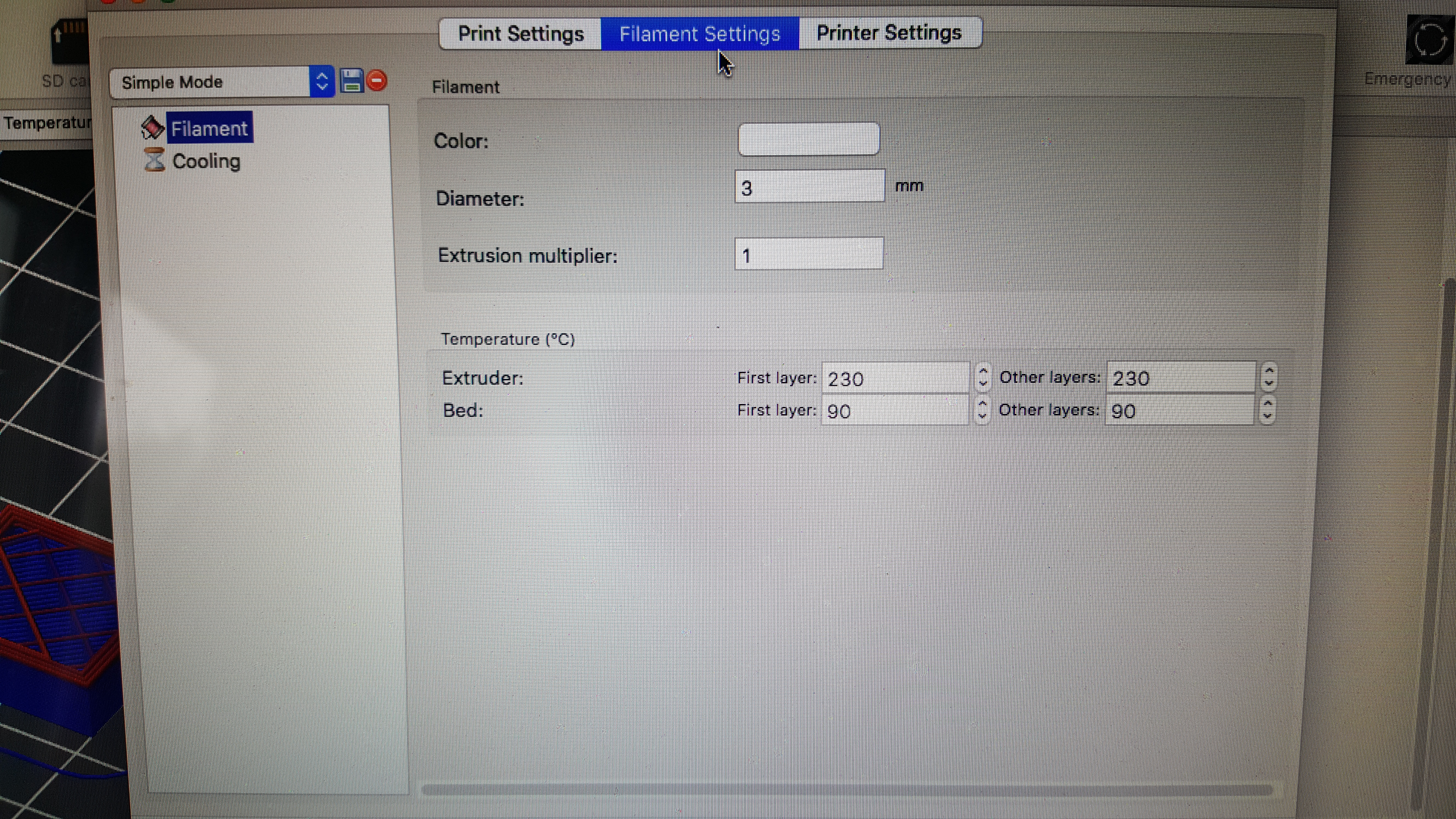

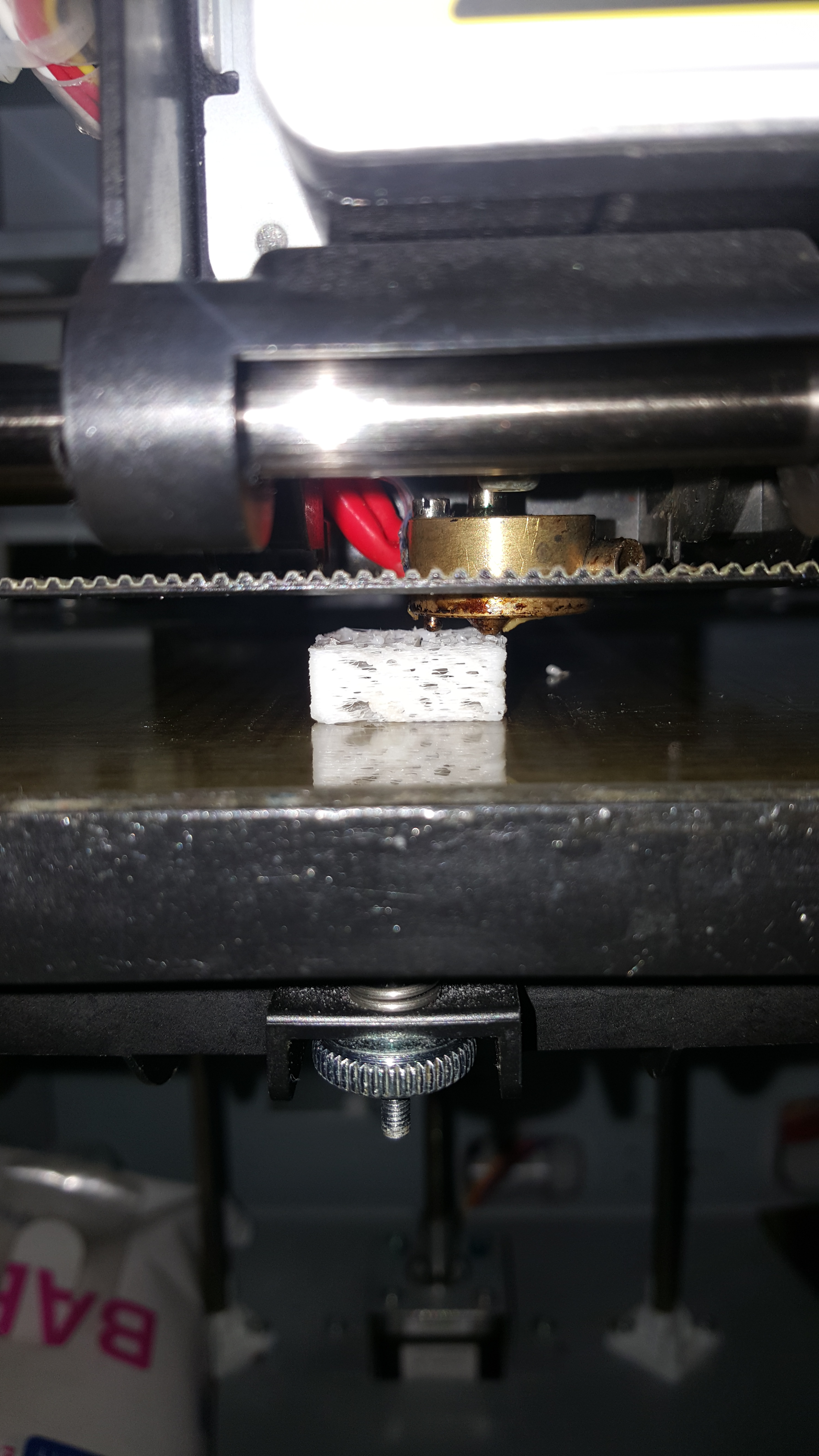

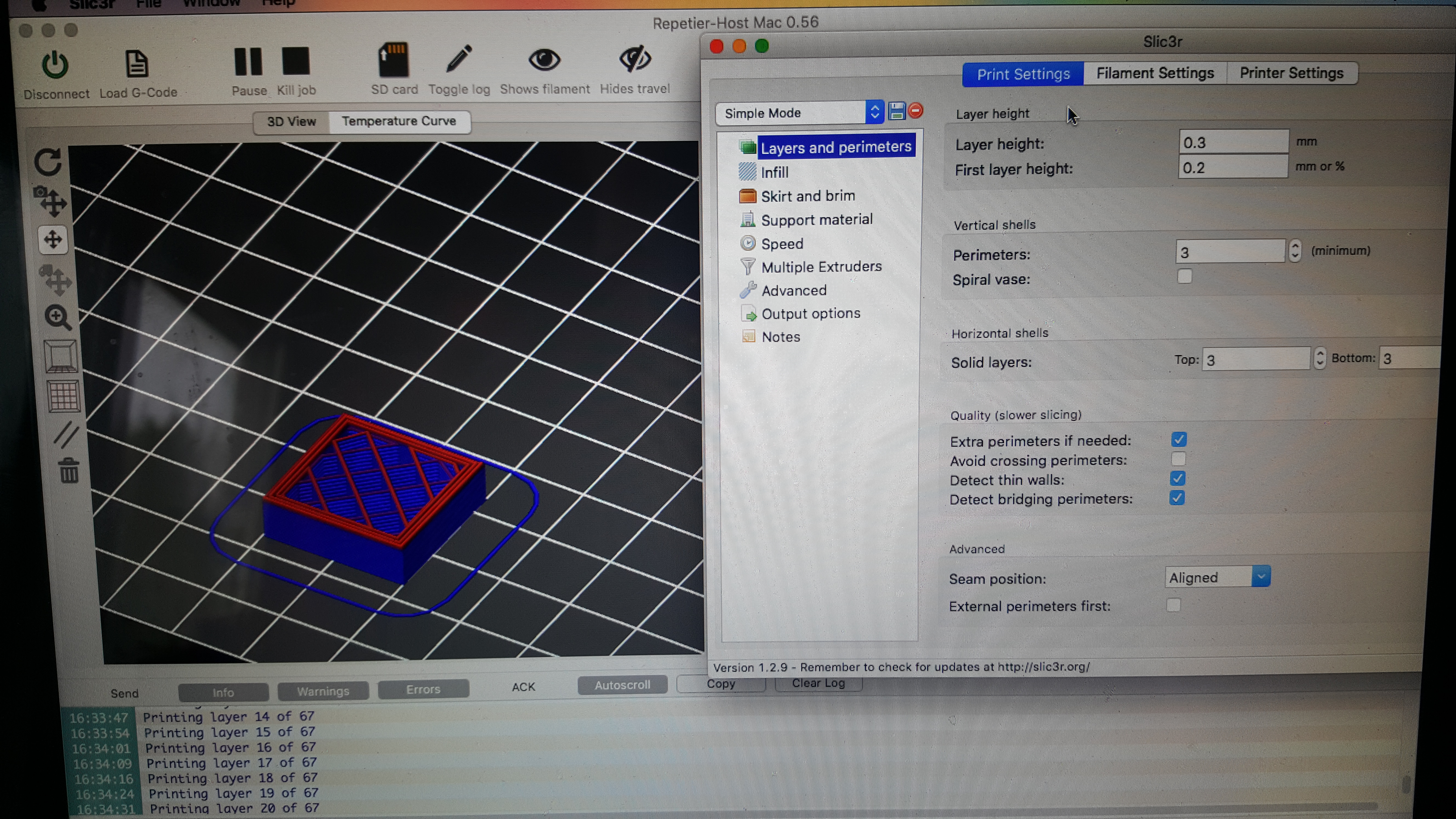

Hello, I dont have a computer with me but let me ask you a few qiestions. Is the box suppose to be solid or like a see through kind of cross hatch. If you are asking about the stringy ness of it. The retraction rate or extrusion multiplier may need tweaking. What I can do is send you some pics on here of my settings. You could dial them in and under close supervision see if anything changes. The other thing. Before this started happening what changes did you make. For example did you change filament supplier. Sometimes the strand size varies and causes all sorts of problems. We will solve this. The clicking nouse coming out of the nozzle I noticed isnt a issue. I read that you use olive oil to lubricate your filament. That may cause an issue with the plastic adhesion. I would try not lubricating your filament. Also my heat setup is 235 extruder temp and 95-98 bed temp. Thank you.

The box should be solid from the outside it issnt supposed to have the holes like in the pictures.
I have this printer for more than a half year or so and i have printed a lot of objects with these settings so i dont think settings should be changed but i would like to give it a try.
I will try not to lubricate the filament but the lubrication makes the filament dust free too.

Sieuwe, It looks almost as if your steps are slightly out of sync. There was a post I think on the solid forum about DaVinci missing steps. The person ended up working the math and changing the step size to more accurate numbers and not rounding up/down to a whole value in the firmware and he saw great improvement on his prints. Unfortunately I don’t have a link to that post but google DaVinci 1.0 missing steps and see what you find. In the article he lists the new steps figure in a table. The basic issue is say each step is programed 21turns per milimeter the reality is its actually 20.963785932 turns per milimeter (**not real figures.**) so that tiny over shoot or under shoot is causing your layers not to line up properly not so noticeable at .3 resolution but at .2 and .1 it’s even more noticeable and has a huge effect on print quality. I’m not sure of the formula he used and maybe it’s in the post. I’m using repetier and I’ve found that the quickest I can push things and still get decent results is at 60mm/s for perimeters infill and support structure everything else are default values.
It also wouldnt hurt to check your belt tension. All three belts. Especially the short one at the back right of your machine. Too tight and you pull the teeth distance out of whack and too loose abd it can skip teeth. I do have a feel its the fact you lube the filament. You could use a dry sponge to filter the dust. Dust has never been an issue with my printers.
