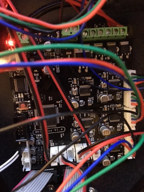

I’m having the very same problems as the OP, but I have not even gotten an initial flash to work. The printer is just a paperweight at the moment. I’m running Windows 10, and I’ve tried Marlin and Repetier, ensured only the one instance of Arduino is running and RH is disconnected, but I still get the same errors:
"avrdude: ser_open() : can’t open device "\\.\ Access is denied.
“avrdude: ser_drain() : read error: The handle is invalid.”
My LCD is still just showing two lines of blocks. I am not discounting that I might have some wiring wrong, too, as it is a board I cannot even find online. It is not the board the chinese instructions showed me, and I took my most educated guess at the configuration. The board states it is an MKS Base v1.4. I am only on my second day of research, but I am hoping to figure a solution soon to just get the thing in motion so I can start the fine-tuning. I am going to attempt to download and try an older verison of Arduino next to see what happens.
