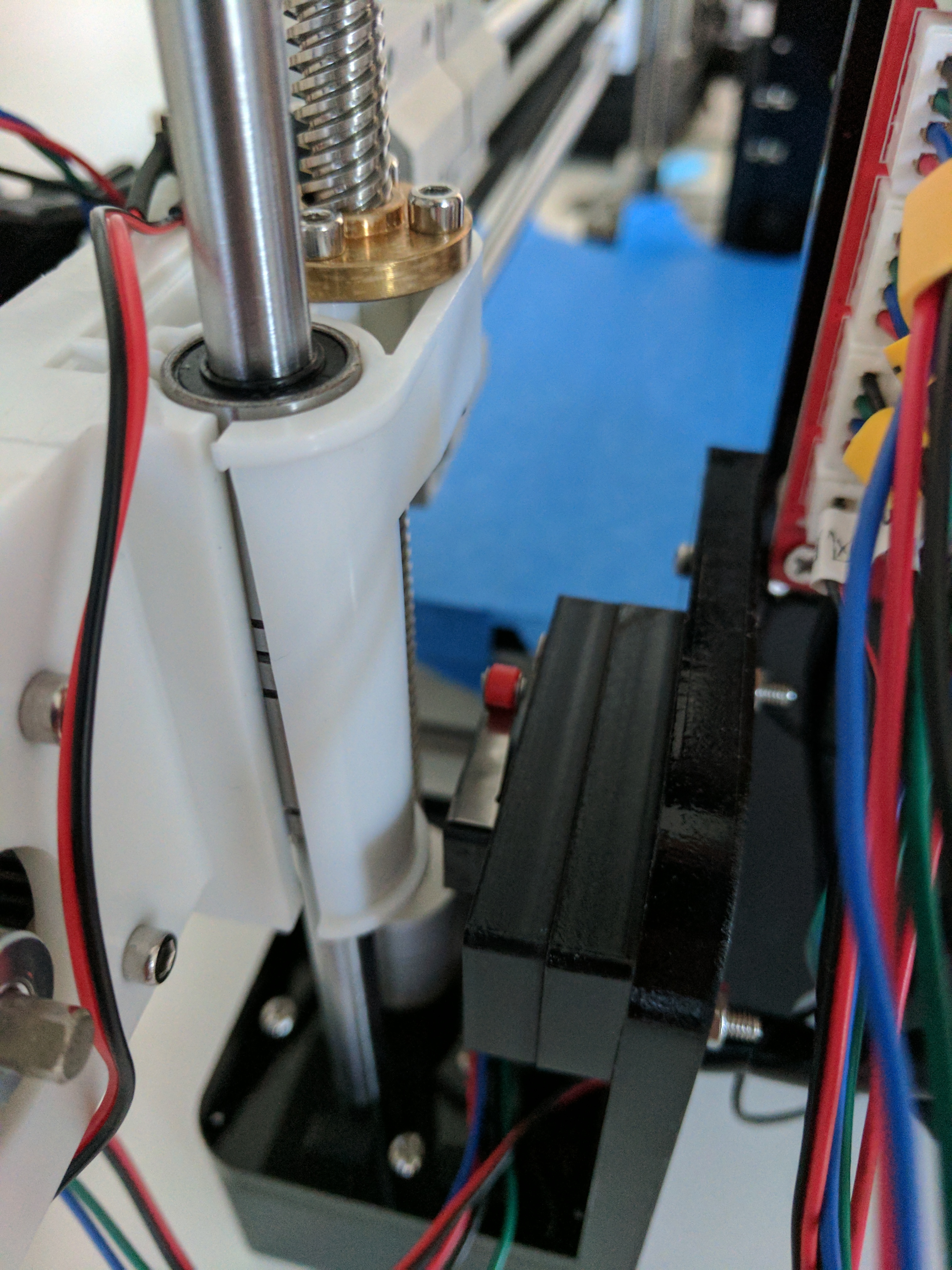

Just powered on my A8 for the first time. I have it do all positions, x and y move and stop correctly. The z on the other hand goes down, hits the stop switch and keeps trying to go. I reset it and started it doing its position test, pressed the switch with my finger and it stopped as it should.
What i’m gathering is the switch is working fine, don’t know why its not stopping the motor when doing it on its own. I tried re positioning the motor up and down, still not actuating when it is pressed by the arm.

Well, if the z-axis stops moving when you press the switch with your finger, then whatever is supposed to press the switch when the gantry is lowering isn’t doing its job. Can you see the part that’s supposed to contact the switch? It might simply need adjusting.
Matwal
3
Yeah… had to tilt the z stop slightly! Thank you sir.

I had the same issue with my A8. Moving the z stop a little upwards solves the problem, as it may appear that you are pushing the switch correctly but it is missing some millimeter.
Hope that helps you.

Looks like I have a very similar issue.
The z-stop is about 1/8" away from anything that would touch it to stop it from moving down. I can’t see where I missed putting something together, nor can I figure out how the z-stop should be pressed.
