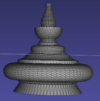

Here’s a screenshot of the piece.
BTW, the image shows the largest of the three. The other two are progressively less detailed and proportionately thicker at the narrowest points for strength.

Your mesh settings on your model are key as well to a great print but that is easy enough to check and make sure we arent getting any triangulation in the models from the mesh settings.
I think the models are easily enough redone if needed. Does it look too coarse? I’m not sure how to do that with my software, I just told it to revolve and it gave me this. Settings, I suppose. Using Delcam Designer.
