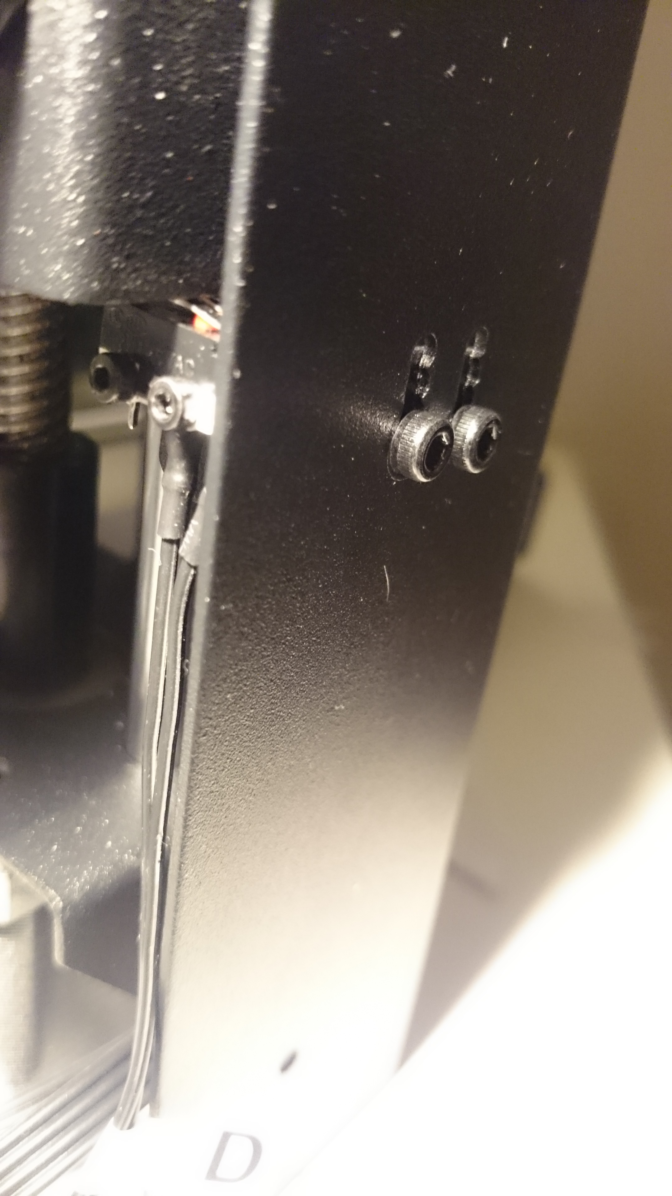

hi, i wanted to make my first test-print with the new printer but there is a distance of ca. 3-5mm between the printig bed and the extruder. Now I should turn the printer off and rotate the stepper motor but there is a swich which is blocking under the left steper motor. (it is able to adjust the hight of the swich but its on the lowest point)
What can I do?
I looked at the Wanhao site, and it looks like the bracket that the switch is mounted on might be slotted as well. Not sure it is, and even so, moving the switch would still leave the bracket in the way. I’d contact them and see what they say. This should be an easy fix for them.
