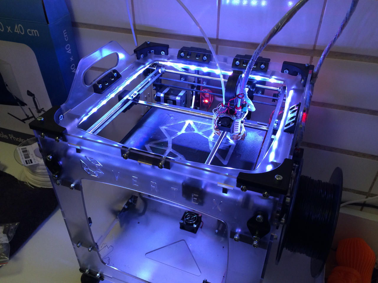

I have added a power switch and some ikea light, both on thingiverse! The power switch i designed myself
that’s cool
how do the lights perform ? is it worth installing ?

It looks great. Very easy install and just €29,95 for the lights. These are the RGB led’s, the white one is even cheaper.
Honestly I still havent finished my first spool of filament yet and since the prints come out fine when using the brim/rafts , I didn’t stand a chance to buy any other to compare it to. What brands would you reccomend for the vertex (PLA)?
It really does and since I’m looking forward to recording a whole lotof time lapses I’m definitly going to install it in the nearest future
