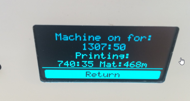

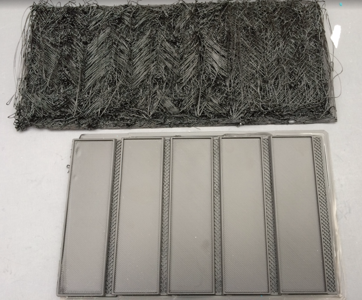

Hi, I posted this on UM Forum, but no responses, so hoping one of the many UM2 users on 3D Hubs might have had some experience of a similar problem to this. I am starting to see (very generally) some quirky behaviour which makes me think that my main board is failing.
1. Z increment too large. I end up with something that resembles the part, but more like a birds nest because each layer is too far above the previous. This starts happening part way through a print (not always the same layer), and the same GCode sometimes works, and sometimes fails.

2. See the screen. It froze like this - in a corrupted state. The print continued, I just couldn’t interact with the printer in any way.
3. The actual printing froze. Stopped moving and extruding but the heated bed was still hot and I think the hot end was too but not sure…this is the most worrying. If the controller loses control in some unpredictable way this could cause a fire.
So any thoughts please…anyone else seen this? Where do I start? To my mind the root cause could be anything… connections, a failing board / corrupt memory, could even be a power glitch I guess…

ouch! looks like a nasty one to me! could the main ultimaker board be over heating? causing a slightly dodgy solder joint to fail/short causing the freeze out? are you able to run the printer with an addition fan blowing across the board?
Either way, sounds like a new main board may be required.

It definitely looks like a malfunction of your electronics. I would suggest to try and print over USB, rather than using the SD card slot. You can print over USB by changing this settings in Cura: Dropbox - File Deleted - Simplify your life If you then connect the printer via the USB cable, the “save to sd card” button in Cura will change to a “print over usb” button.
I don’t think the board or steppers are overheating, like numerous people are saying. If that would be the case you’d see shifted layers, rather than a complete crash of the printer. Of course it’s possible you’re experiencing multiple issues at the same time.
