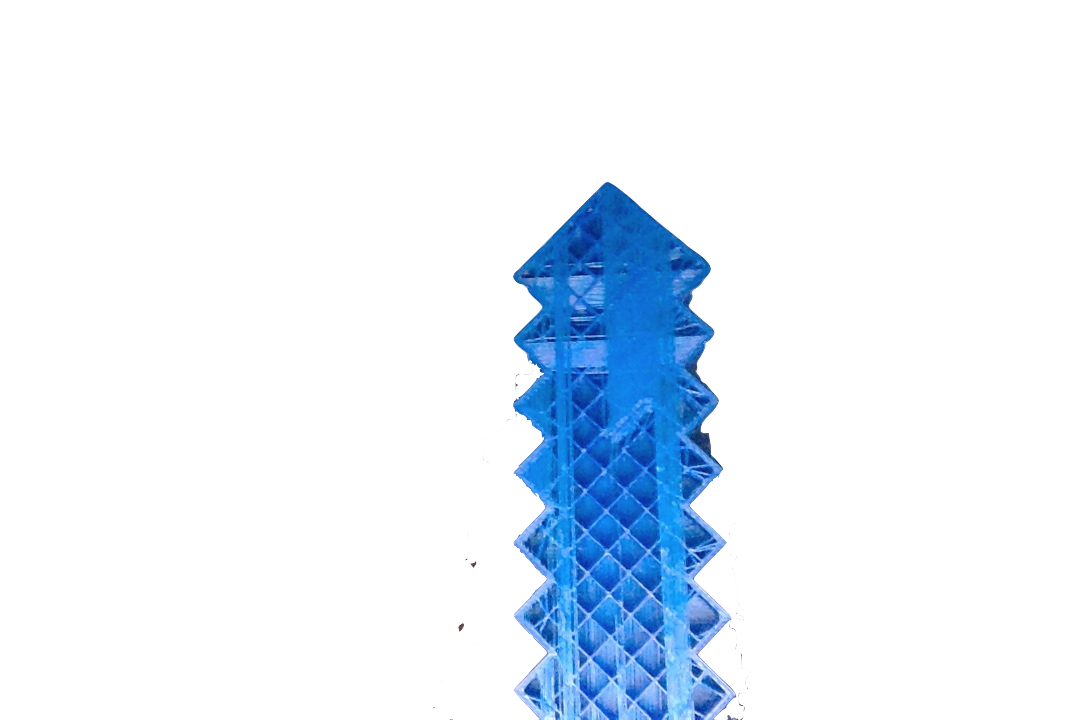

I’ve recently been having an issue with my Flashforge Creator Pro. I am using Replicator G to process my STL’s to GCode, just in case that might be related.
What is happening is the top few layers are now being printed completely, resulting in the middle part of the print exposed. There are some strings on the top, as if it was able to print small bits of the top layers. However, for the most part, the square pattern which fills the print is exposed, and the top layers aren’t there. This has been happening for all prints ever since the issue started.
I have a picture attached to this thread of one of the prints with this problem (if the picture doesn’t work, it can be found online here: http://imgur.com/GWKMNTP)
Does anyone know why this is happening, and how to fix it?

I think it’s not related to the printer but to the slicer software. Did you check if your slicer software is up-to-date or try using different slicer software to see if this fixes your problem.
Use flashprint, its flash forge’s own slicer and works brilliantly for me- its free too :slight_smile: http://www.ishare3d.com/3dapp/public/FlashPrint-ii/ The latest version is 3.10.0
REPLICATOR in G can set different layer thicknesses may be that they are defined with too low thicknesses to be Printed…

Hi Aidan, are you getting any buildup of filament around the nozzle/print? In other words, does it look like the filament that should have been there for the top layers IS getting extruded, but not laying properly (i.e. potentially an adhesion problem), or is it entirely missing (i.e. potentially a feed problem)?

I use simplify3d with 4-5 top layers which works awesome!
Hope this will fix the problem, let us know if it’s fixed.
Try printing more than 1 top layer. Also, make sure your top layer is printed at the correct extrusion.
Experiment with top layer speed. Up/down.
Finally, use different slicing software. There are so many options beside replicator G, which was abandoned years ago.
Flashforge recently published flashprint, which will work great with your printer.
Simplify3d is the gold standard, and will make your day!
