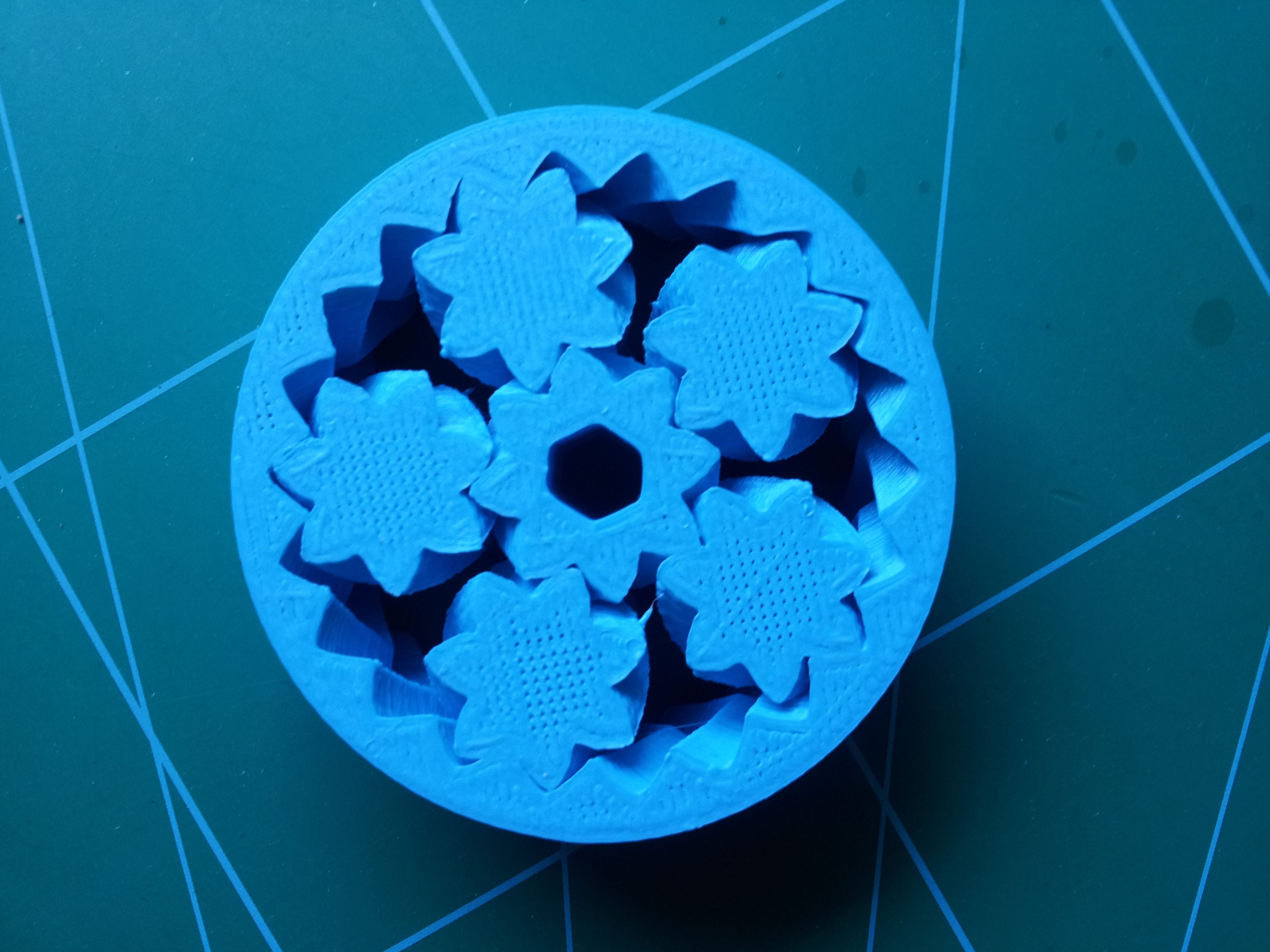

I have some problems with the gears test with my Ultimaker Original in PLA Ultimate-Blue. The problem is with the printing result that the gear teeth are printed together. I put all the pressets of the Ultimaker Manual, the .gcode and doesn´t work. I ´ve tried three times changing some pressets with best quality but no way. What can I do?

On a UM1 it was a challenge - a mix of speed and temp to get the support to print properly while not sticking everything together.
I print on glass (cold) with colorfabb pla/pha and found for a reliable spin I needed the first layer to ‘just’ be touching - more of a bead than a smoosh and slowed it down to about 75 as the 100 was not letting the support print properly at 210degrees - in fact I think that is why the 1.2 mm top/bottom layer is important because I normally do a way thinner layer than that.
but no one looks inside the model :slight_smile:
Took a few apart that did not work and the ricky one was the outside to cog - which was well stuck in early tried, but the centre cog was free - now having done a few (wanted to check I could repeat it) i know that when the firstlayer is printing if the outer cogs touch the outer edge then it will not work - so can abandon after the first layer, adjust the flow (I am using 98%) and start again.
James
