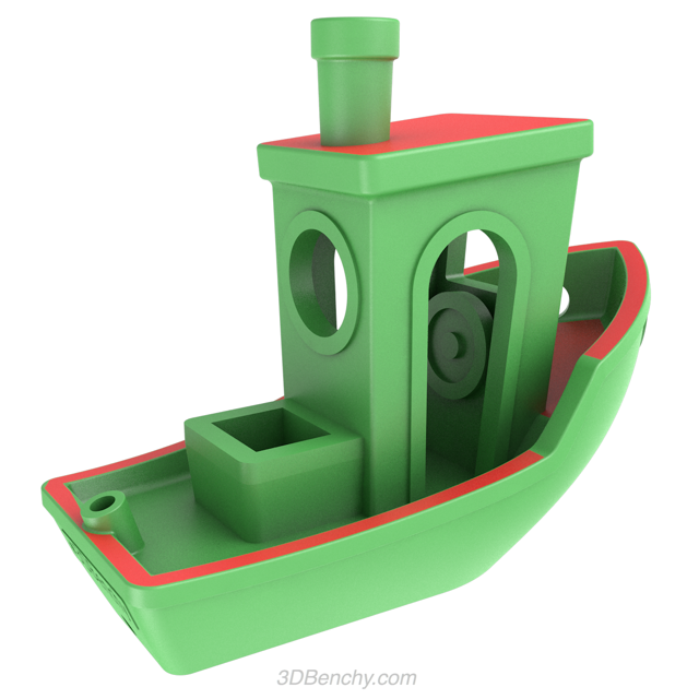

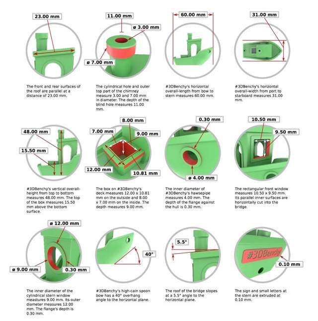

We therefore developed a slightly different 3D model with pre-defined features that can you can download and use to measure and calibrate your 3D printer. This part also strongly resembles the shape of a boat by the name of #3DBenchy. So after the part is printed and you used your caliper to gather all the necessary dimensions, don’t throw it away! Give it to a child to play with
Or to an adult!

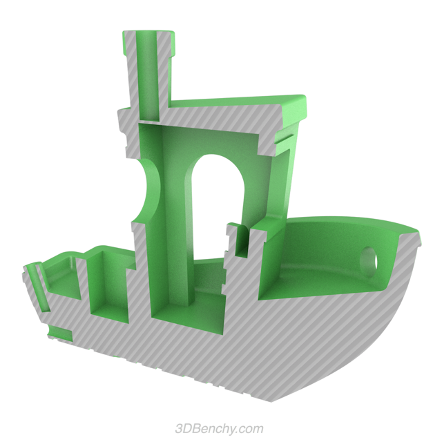

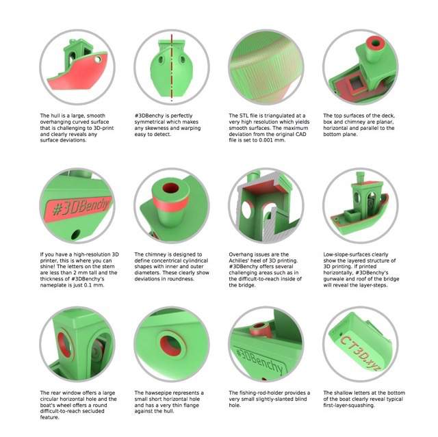

#3DBenchy is carefully designed to offer as many different measurable features as possible, all in one single part. It is just a tiny little boat but don’t let the small size fool you!
This STL file is quite difficult to print perfectly since it has several hard-to-make surface features which clearly show the challenges for different kind of 3D printing technologies.
Its recognisable shape, symmetry and the smooth overhanging curved surface of the hull, make 3D-printed versions of #3DBenchy very revealing of what can be improved on a 3D printer or its slicing software.
Some of the features put into this boat are as follows:
