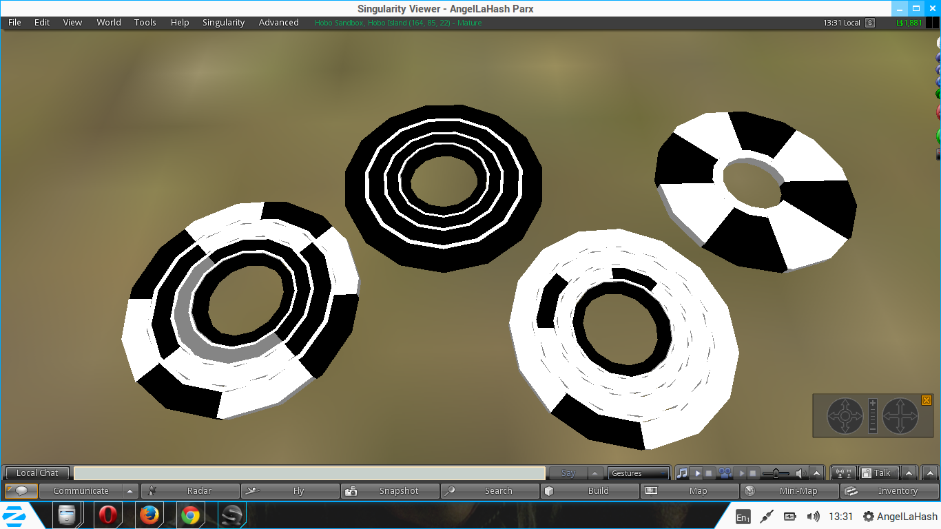

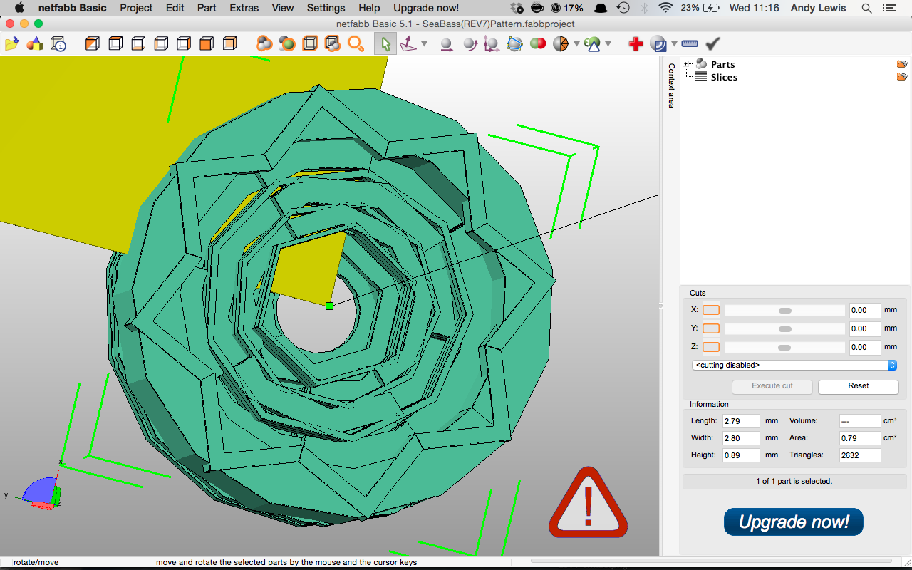

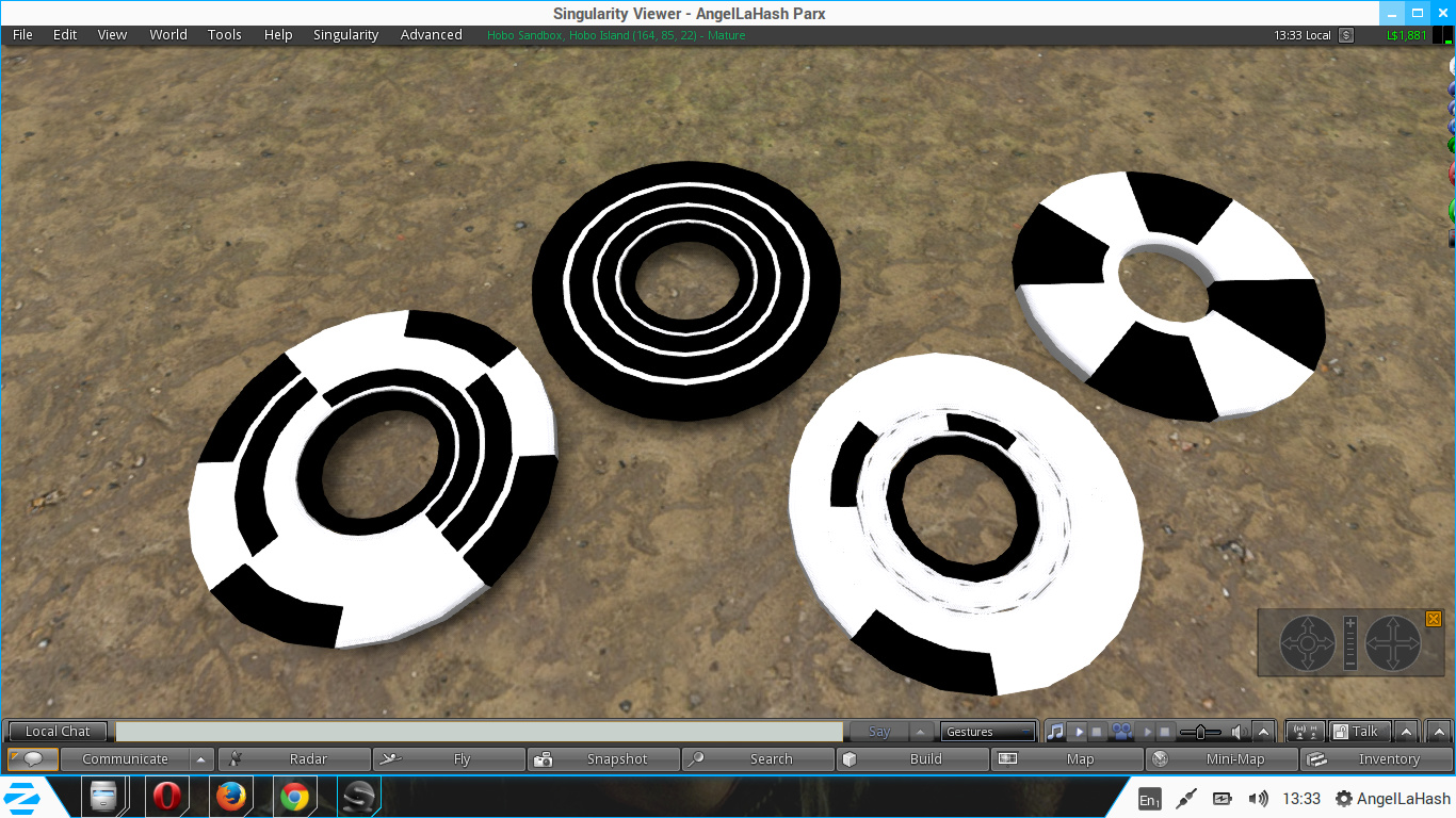

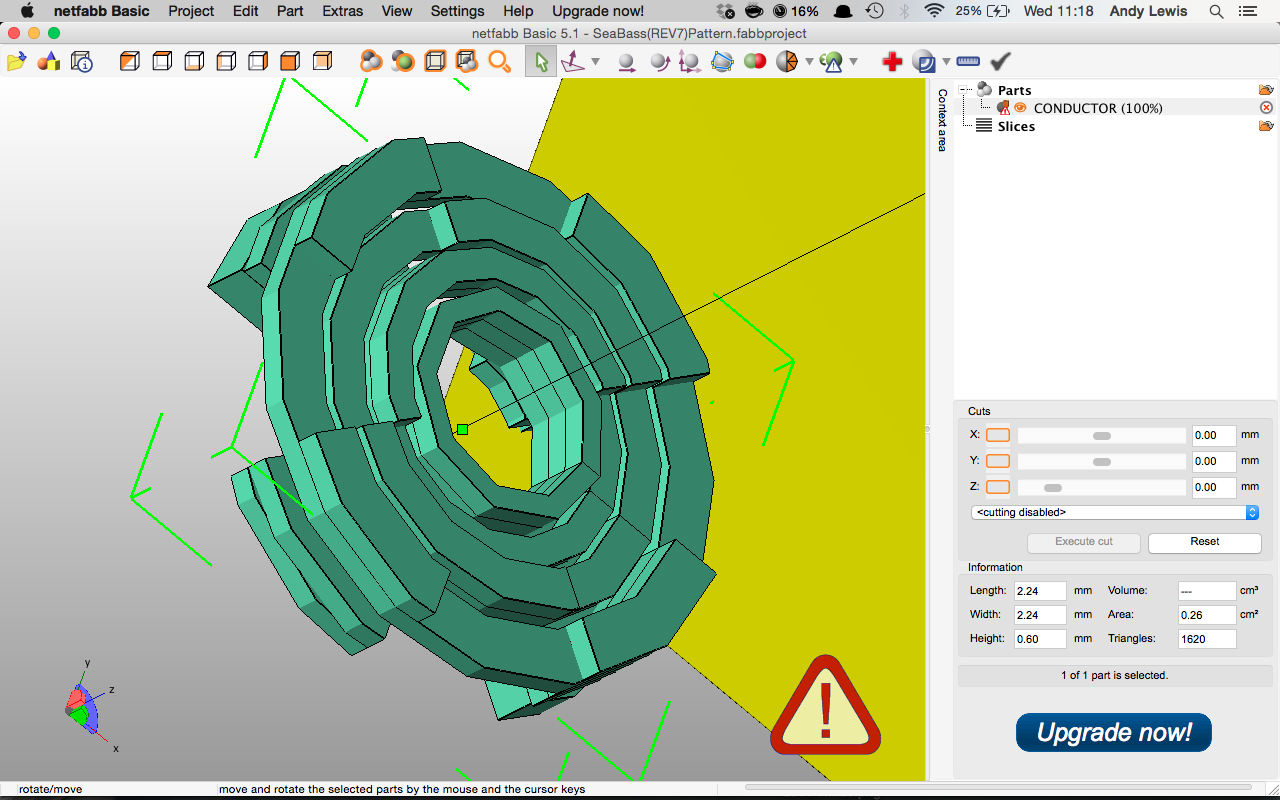

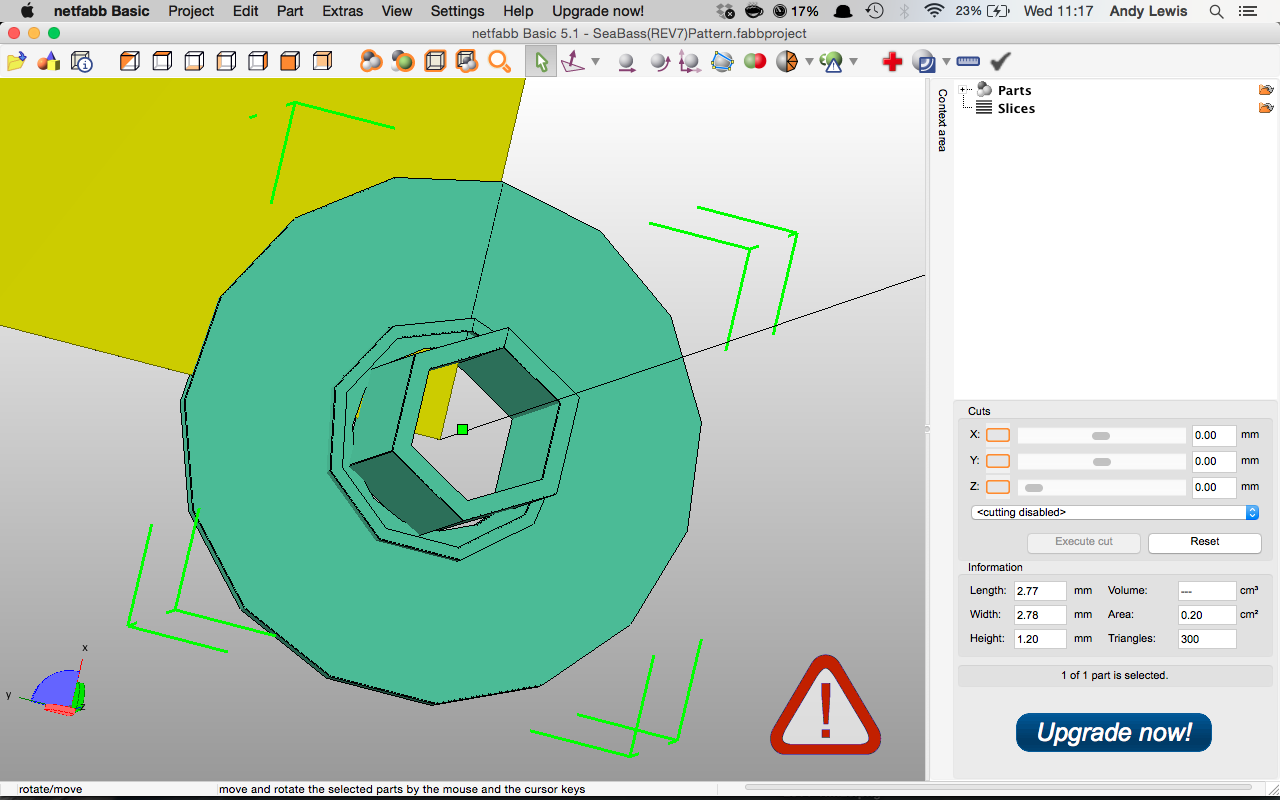

Tried so many things, im just going to have to try and find a WINDOWS PC and get some Software for that…
D=62mm H=22mm+10mm=32mm
Ring1
D=60.0, Ring is 5.75 Thick and 2mm tall, (045-090, 135-180, 225-270, 315-360 Conductive) (000-045, 090-135, 180-225, 270-315 Non Conductive)
D=46.5, Ring 5.75 Thick and 2mm tall, (090-180, 270-360 Conductive) (000-090, 180-270 Non Conductive)
D=33.0, Ring 5.75 Thick and 2mm tall, (180-360 Conductive) (000-180 Non Conductive)
D=19.5, Ring 5.75 Thick and 2mm tall, (000-360 Conductive)
D=48.5, Ring 1 Thick and 2mm tall, (000-360 Non Conductive)
D=35.0, Ring 1 Thick and 2mm tall, (000-360 Non Conductive)
D=21.5, Ring 1 Thick and 2mm tall, (000-360 Non Conductive)
Ring2
D=60.0, Ring 5.75 Thick and 2mm tall, (000-360 Conductive)
D=46.5, Ring 5.75 Thick and 2mm tall, (000-360 Conductive)
D=33.0, Ring 5.75 Thick and 2mm tall, (000-360 Conductive)
Ring3
D=60.0, Ring 5.75 Thick and 2mm tall, (045-090 Conductive)
D=46.5, Ring 5.75 Thick and 2mm tall, (135-180 Conductive)
D=33.0, Ring 5.75 Thick and 2mm tall, (225-270 Conductive)
D=19.5, Ring 5.75 Thick and 2mm tall, (315-360 Conductive)
D=60.0, Ring 5.75 Thick and 2mm tall, (090-045 Non Conductive)
D=46.5, Ring 5.75 Thick and 2mm tall, (180-135 Non Conductive)
D=33.0, Ring 5.75 Thick and 2mm tall, (270-225 Non Conductive)
D=19.5, Ring 5.75 Thick and 2mm tall, (000-315 Non Conductive)
Ring4
D=60.0, Ring 26 Thick and 2mm tall, (045-090 Conductive)
D=60.0, Ring 26 Thick and 2mm tall, (135-180 Conductive)
D=60.0, Ring 26 Thick and 2mm tall, (225-270 Conductive)
D=60.0, Ring 26 Thick and 2mm tall, (315-360 Conductive)
D=60.0, Ring 26 Thick and 2mm tall, (090-045 Non Conductive)
D=60.0, Ring 26 Thick and 2mm tall, (180-135 Non Conductive)
D=60.0, Ring 26 Thick and 2mm tall, (270-225 Non Conductive)
D=60.0, Ring 26 Thick and 2mm tall, (000-315 Non Conductive)
Well thats the 4 rings that is the main body. Just the Case and the Connector
