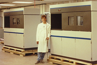

The process of fusing powder material by using a laser was an idea of Carl Deckard, a mechanical engineering undergraduate from Texas University. Throughout his study he developed this additive manufacturing idea. He assembled a team of professors and businessmen, launched his first company and assured funding to further develop his idea. In 1986, after obtaining his masters degree, he filed the patent for his SLS idea. After ‘86 Deckard and his team built the company ‘Nova Automation’, which later became ‘DTM’. After another round of funding, DTM built the first commercial SLS machines: Mod A and Mod B (both part of the 125’s series).
(Paul Forderhase with two 125’s)

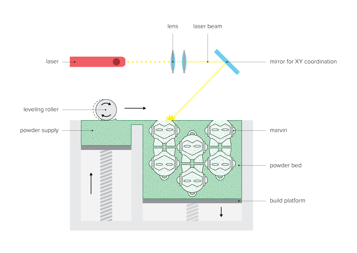

The process
The name of the process already gives away 90% of how it works. Selective Laser Sintering is a process where a laser selectively fuses (sintering) material. Step by step it works as follows:
  1. a layer of powder is coated onto the build platform
  2. this coat is melted by a laser
  3. the build platform is lowered
  4. a new layer of powder will be laid on top
  5. the process repeats itself
The most common material that is being printed with SLS is ‘Strong & Flexible’, which is white Nylon powder. True to its name, it’s strong and relatively flexible. Furthermore the powder allows for printing moving parts in one go, as well as printing without solidified support material.
It’s important to note that the whole tray of unsintered powder is already heated until near-fusing temperature, the laser does the last push.

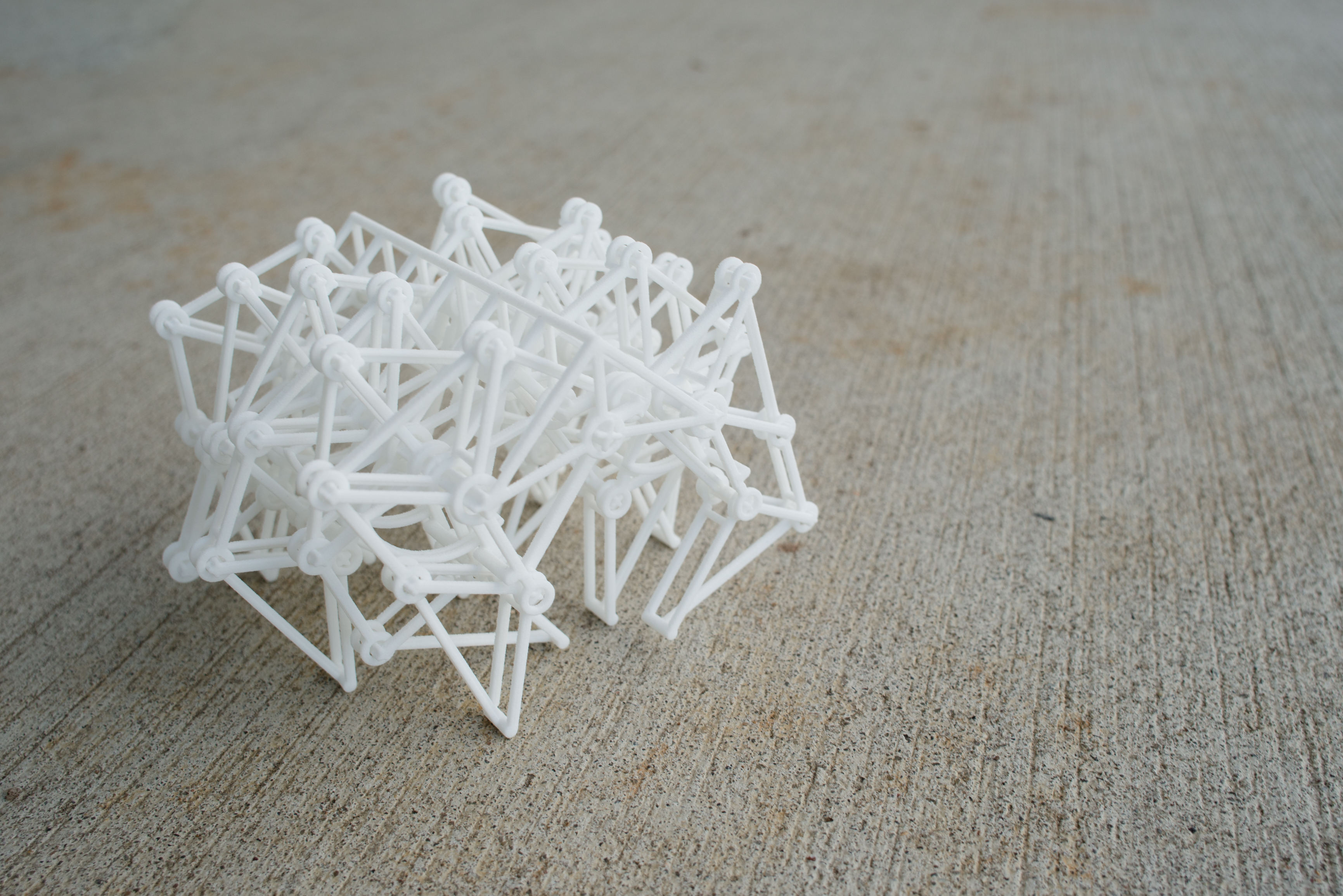

(strandbeest by Theo Jansen)

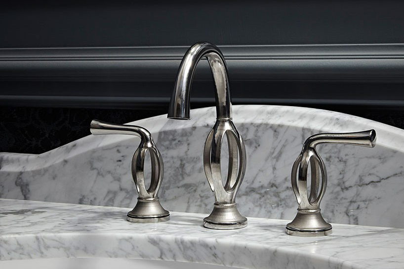

(DWX faucet (actually SLM))
