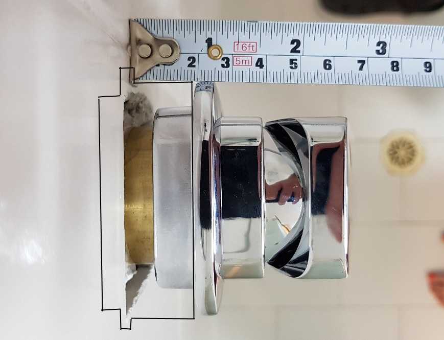

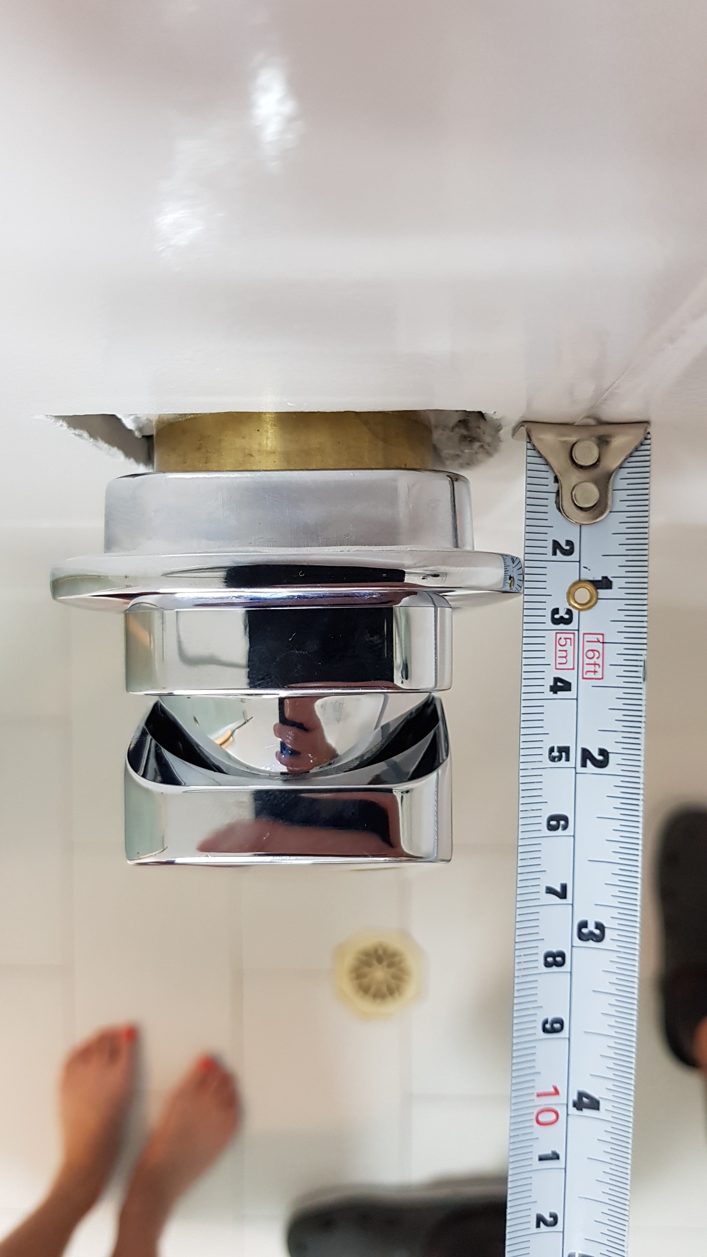

we need to recreate the 2 attached shower tapware parts. These parts need to be 25 to 30mm longer.
I need some help to get me a 3D design for these parts so I can get them 3D printed in a water resistant material.
Can anyone help me with this? I attached a couple of pictures to give you an idea. I can send more pictures to those interested.

Can you have a separate piece designed that would take up that gap. It could be sanded and painted with a chrome color paint. You wouldn’t need any thread on the plastic part.

thanks for your feedback. Incorporating Jeff’s feedback, we could design a simple square piece that would be extending the existing part. I would have to do a junction between the 2 parts. I imagine I could tape the inside where the 2 parts join and seal it so no water is linking inside the mechanism…
I am a little time-poor right now… How much would it cost to design and then print (in a water-resistant material) roughly 50 x 50mm, 30mm deep?

if u send a drawing of the piece, with dimensions, as accurate as possible, I could tell u how much would it cost to 3d design it.
This is going to sound realy silly! lol, but can you not cut the pipe off shorter so it fits flush to the wall?
There is the mixer mechanism in it. It’s a good idea but we would get into more trouble!!

I would assume it would take an hour or less of design time. Guessing to print the part, say in a PETG material could be $10 to $15. That being said, I assume by the times that you are responding to these posts, that you are not anywhere near my time zone
. I suggest you find a hub local to you, that can also do the design for you, or do the design yourself as suggested.
I don’t think you need to replace the part, I think you just need an extended cover plate from the wall to the backside of your current cover plate. I’m guessing the plumber left the pipe too long or you’re missing the piece I’m talking about. I created one based on what I can see from your pics. Hopefully the image will come through.
https://www.thingiverse.com/thing:2643159
Or go to tinkercad and type in faucet collet in the search engine and you will find my design.
