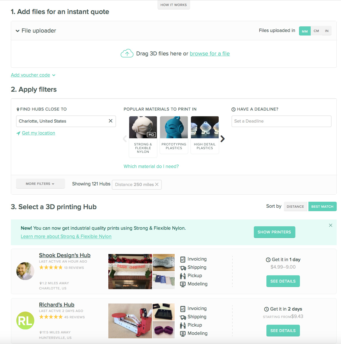

Why are hubs that are hundreds of miles away showing higher in the search rankings? My hub has good reviews, plenty of completed orders, and I’m one of the few hubs in my metropolitan area. It seems kind of ridiculous that a hub with 2 reviews and a distance of over 100 miles away would rank higher than mine for people searching my exact city. On top of that, I have the lowest prices and a plethora of materials available. I’d like to see a very clear explanation of the search ranking scoring system because this just doesn’t seem right…

For me you are first to show up when looking for Charlotte (See screenshot).
Maybe you have some filters on ?
Let me know if you still have the issue !

Justin, I’ve also replicated the search and you’re the first on my list as well - see screenshot attached. Feel free to reach out if the problem persists though. Cheers

It would be useful to share a screenshot of what your exact search looks like. We are testing different rankings at the moment, but I’ve just checked both versions and you rank #1 and #2 in both.

I appreciate the follow-up. I noticed this issue right when I turned on my hub right after the Thanksgiving weekend. I was searching on an Apple iPhone 5S, and as you probably know, you can only see one listing at a time on a device with a smaller screen resolution. I was at the bottom of the first page at the time right after turning on my hub. I just checked again on my phone and I’m #2 which looks correct. Could there be some lag after turning on my hub?

Hey Justin, glad to see everything was resolved. Indeed there could be a little lag between you being active on the platform an our ranking adjusting for that (we tend to favor active Hubs over idle Hubs for obvious reasons), we don’t have any documentation publicly, but we’re working on making pointers available on a Hub level, so it can be more tailored to the Hub.
