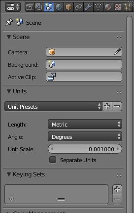

What blender version are you at ? In my version the file just exports, with no options…
Blender version 2.78
you?
I’m using this setup on Blender and export the models 1:1 Scale
to double check my units I open the STL file in Netfabb
