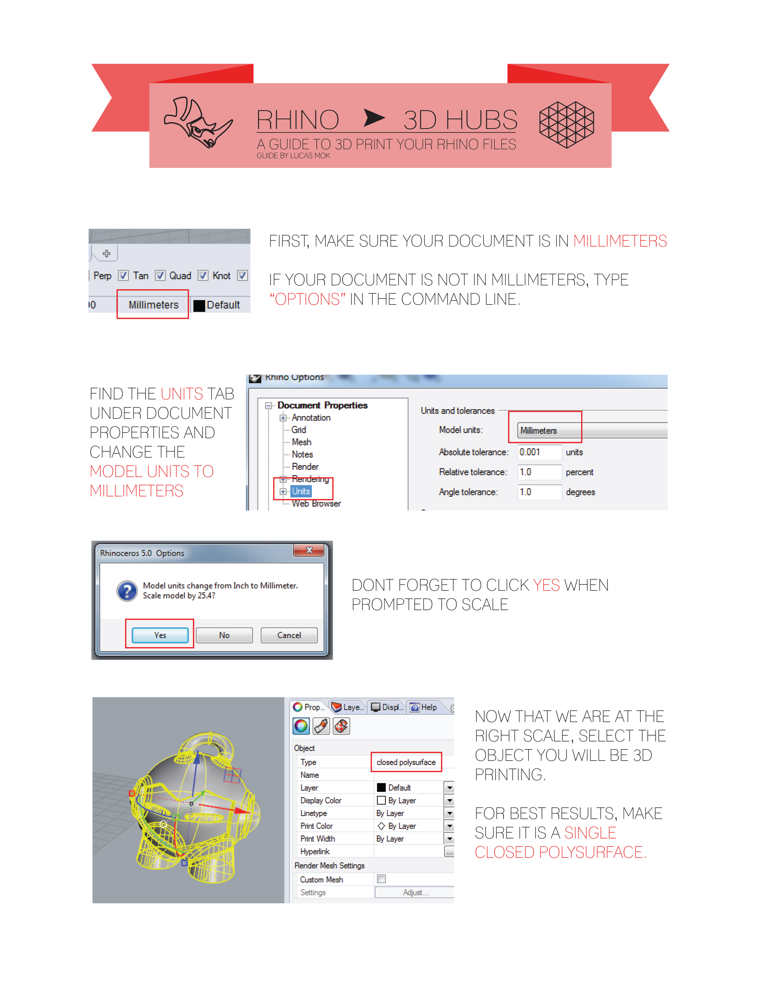

Craftee
Export your Rhino 3D models to be 3D printed on 3D Hubs.

Cool infographic, @Craftee! How’s the learning curve on Rhino? Never tried it myself, but I’ve seen some really amazing results coming from it.

In my opinion it is easier than other programs. you type what you want in the command line, even when you dont know a command or function exists, for example you want a line, type “line”. you want a box, type “box” you want to chamfer an edge, type “chamfer”. and google is your friend.
