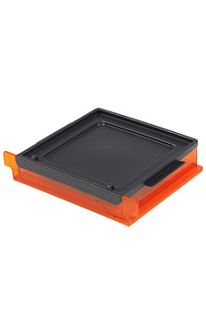

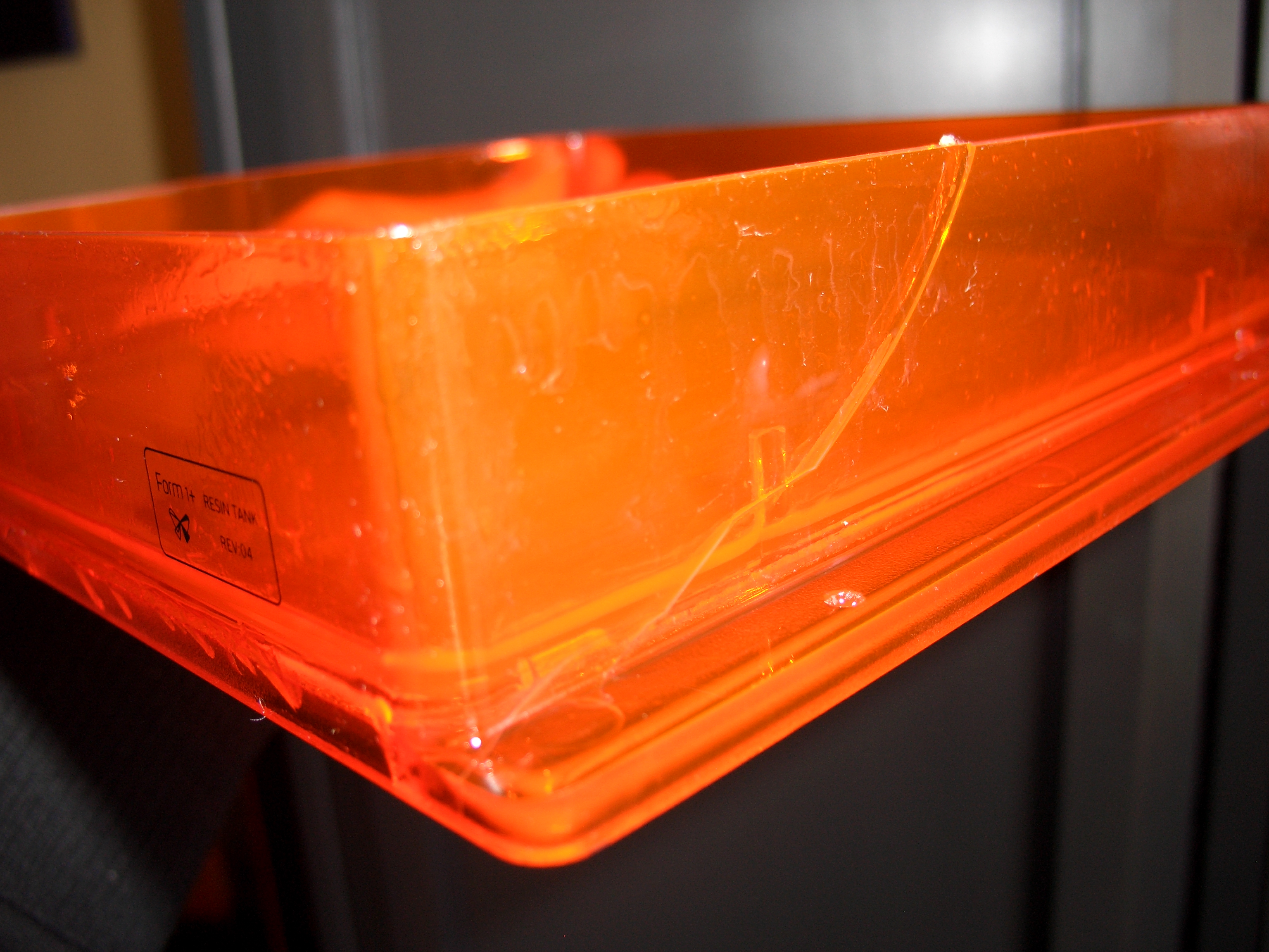

I’ve been using the old resin tanks for a while now, but they seem to be breaking in the corner.
Is someone aware of a new generation of Resin Tanks that will not break.
I have to buy new ones.
Yeah with new tanks they’ve removed the “spout” in the corner that was creating a weak spot, now the tank is the same thickness in all corners so shouldn’t have the cracking issue.
Hey Dennis,
make some pictures of the broken tanks and create a support ticket. They know about the problem and will send you new tanks for free.
Frank
What Dennis said.
Also (in case you have old ones still yet to use) try to lift the black lid off vertically, rather than tilting up from the front. This seems to be what often causes the cracking.
For me the protective lid was breaking the trays. I trimmed the outer part away from the back and half the sides and haven’t cracked one since. Didn’t cut the top, just the outside.
There is a known issue with the “spout corner” cracking and pieces of plastic breaking off. There have been a few temporary fixes, such as adding strong tape to the outside of that corner. You can also buy resin tanks from another company, https://www.zvatindustries.com/
unfortunately you have to buy new one ,you can check these tanks from Zak
they have made an excellent replacement of the original tank (and solve a lot of problems that original vat have )

That’s right, take a photo showing all the tanks then zoomed in pics of each tank where the damage is.

Can confirm, new tanks are cracking too, it is definitely worth to shoot a few photos and open a support ticket.
Photo attached about the last one of mine, that was ordered in November and lasted for half a bottle.

Hey @Left and @Temujin,
thanks for the talk. We are reselling these glass vats of zvatindustries here in Europe. If you are interested check out some further info of the spec here.
These very durable and resistant glass vats are a great benefit for lowering operation and maintenance cost for your SLA printer.
