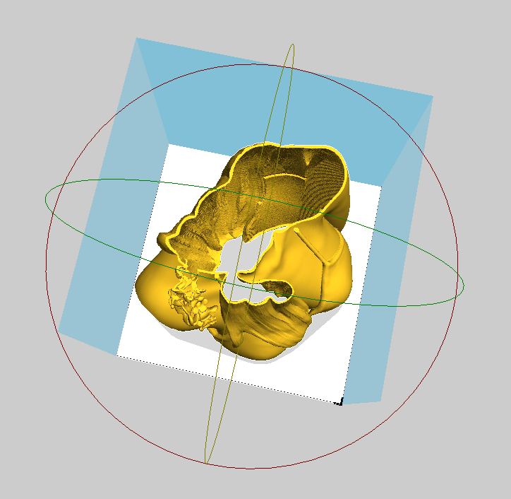

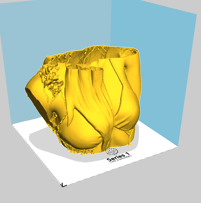

Can’t find tips on printing maxed out models on my new 2015 Type A Machine.
As a week old first time printer I’ve had some success with smaller ‘solid’ models.
I am guessing the secret for really big models ( besides orientation) is slicing and making model hollow.
I did both in ZBrush and am going to try out bottom half of female bust (attached).
Cura says 72 hours and 296 Meters of filiment (almost 1 KG spool).
Imported (Into Cura w/no supports or raft)) Meshmixer .obj w/ supports + 55 hours and about
180 meters of filiment. Sound like a better option?
Attached model has its ‘walls’ about .7cm apart and solid mesh. Will type a mostly just print it’s .8 shells
at walls and fill between?
Any tips would be greatly appreciated! Glenn- marooned in Kauai.

Hi again! Lots of good advice, Thanks. I am a bronze sculptor and have cast bronze and see at bright future for 3D in production. I went back and tested my design in Cura again at basic settings with raft and supports at both 150mm and 282mm Heights:
Solid Mesh - 150mm - 18 Hr - 121M material
Hollow Mesh -150mm - 37 Hr - 140M
What you pointed out is true Solid is more economical at 150mm.
Keeping in mid that this object is basically a tubular structure I tried a larger size…
Solid Mesh - 282mm - 91 Hr - 735M Material
Hollow Mesh - 282mm - 76 Hr - 306 M
Hollow mesh with Meshmixer supports/ no Cura supports
- 282mm - 55 Hr - 158 M Material
According to Cura Hollow w/Meshmixer supports is fastest/cheapest. But this is not in the real world
next I’ll have to try it. Yikes!

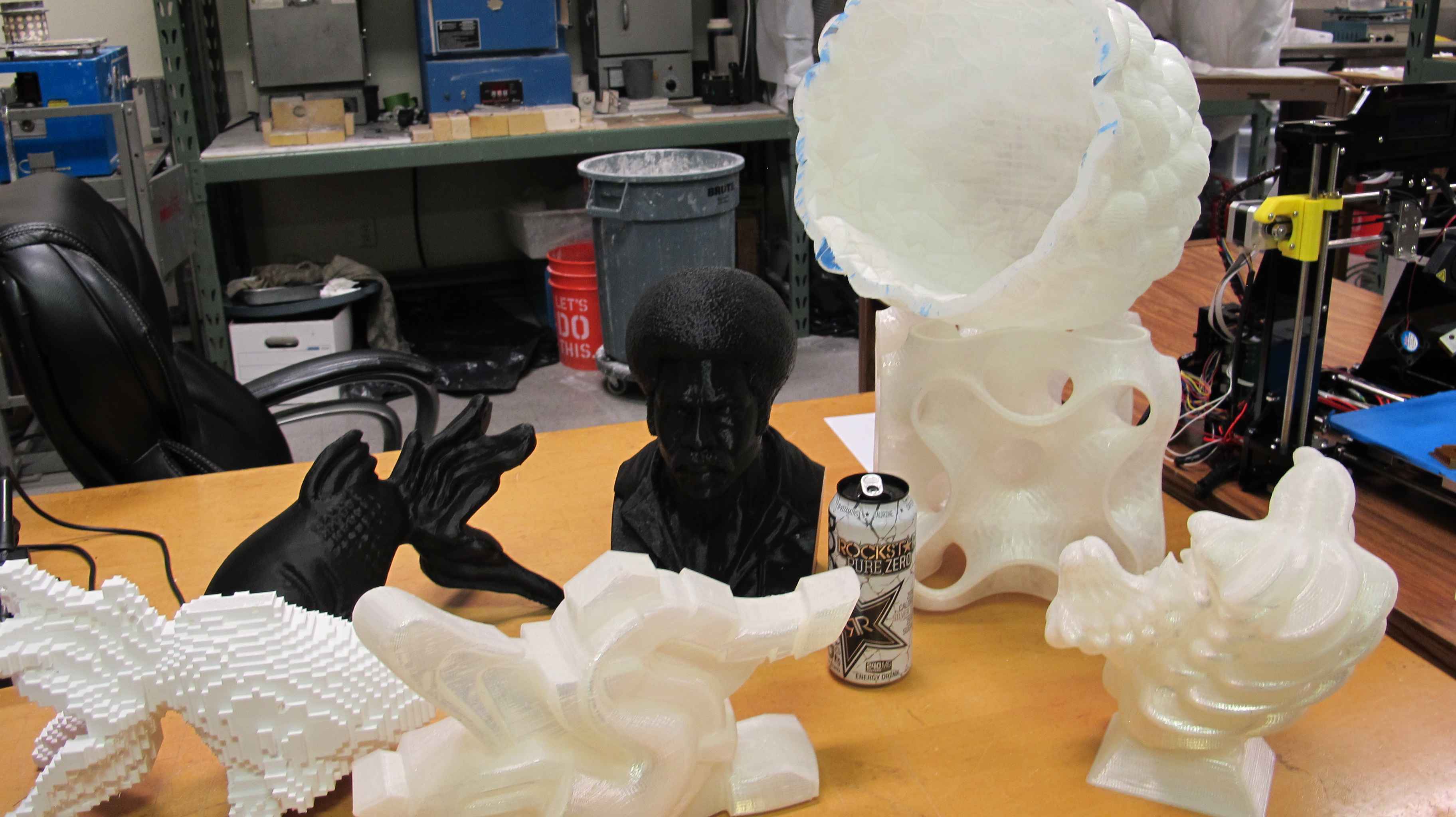

So just following up on the concept of overhangs being somewhat model specific.
Here’s a worm gear… I don’t know what this is but it’s easily over 70 degrees overhang.
