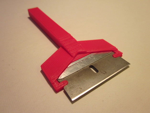

Hey there! There was a discussion on this earlier as well- Check it out: Talk Manufacturing | Hubs. The attached picture was provided as a solution maybe ^^
