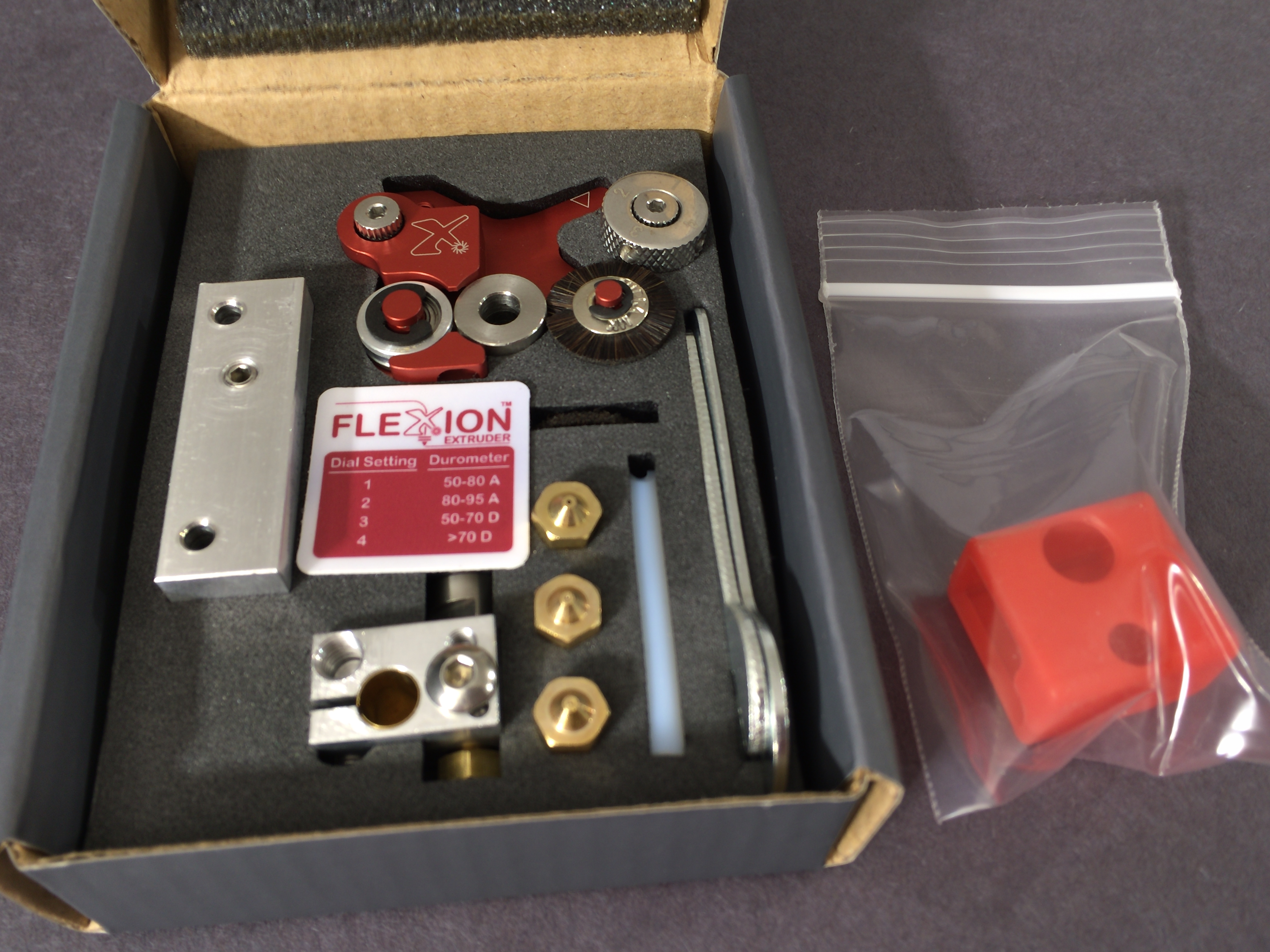

I love my Wanhao Duplicator i3 Plus but there are some upgrades that I made. First was the print bed. The screws on the stock bed were not flush and the print head would bump into them when leveling the bed. I bought a RepRap Champion countersunk screw hole build plate that fixed that issue. It came with a 24v capable heater. It printed very well with just that upgrade. There is a minor ringing/ghosting issue that mine has on the prints that I have yet to be able to fix. I also upgraded to a Swiss Micro all metal hotend and Flexion extruder. With both combined I can print rough materials and flexible materials with no problem. As for software 123D Design and Fusion 360 are very good for creating parts very easily. Cura is great for slicing and many people use Simplify 3D but that one costs a lot of money. I have matter control installed but I haven’t used it yet. I mainly use Cura. Repetier-Host is another great slicer. I like Cura because of the nice looking and fast user interface. So far I’m very happy with my i3 Plus with the mods but I really wish I could figure out the ringing/ghosting issue. Everything I’ve tried hasn’t worked.

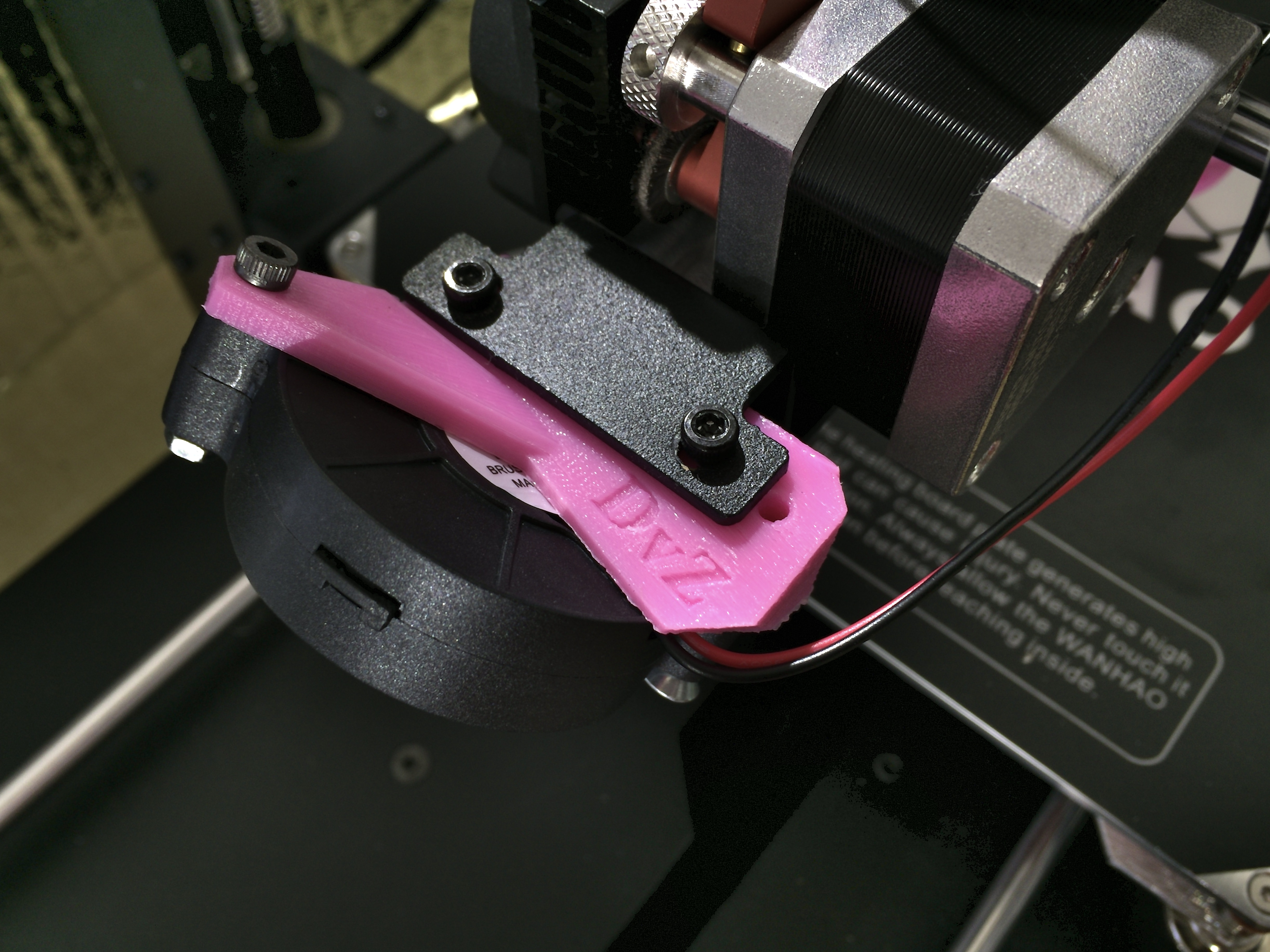

Oh, I forgot to mention that I just installed a blower fan to cool the filament and it’s working great!
I have a similar fan upgrade on mine as well and it’s more or less a must. Same with the Swiss Micro all metal hot end. I’m curious what your upgrade is for your filament stepper. I haven’t seen that before. I used to have a lot of ringing and ghosting, but it’s almost all gone once I added Z braces and changed the x/y acceleration and jerk as needed along with removing the belt tensioners.
I’m using the Flexion extruder so that I get consistent force on the filament. I’ve changed the x/y acceleration and jerk, removed the belt tensioners, and done everything possible with the software. I’ve seen the Z braces but I don’t have the parts necessary for it yet. Hopefully that’ll fix it for me. The Micro Swiss combined with the Flexion extruder are a perfect combo for the i3 Plus and other similar printers :slight_smile:

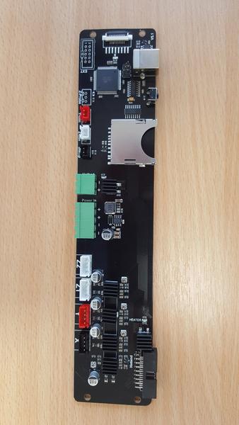

If you choose to go with Wanhao, the first thing you want to do is make the proper repairs to the main board to cut down on the risk of fire. Wanhao has been cutting corners when it comes to the connectors used for the power connections on the board and it has resulted in many fires. There are instructions on what needs to be done in many places. It basically involves either changing out the connectors or soldering directly to the board. If you value life and property, I would address this issue before doing any of the other upgrades to this printer.
Has that been reported for the i3 Plus? It has an updated board from the i3 v2.1 Another fire warning deals with the springs that can scrape into the heater plate and cause shorts/fires. They sent out fiber washers for that issue.
Yes, I have checked the idler pulleys. It was also loose for my y-axis and I tightened it. The others are good though. I’ve reduced the ringing effects to mostly the y-axis. I’ll do the z-brace fix later on which should get the ringing/ghosting down to a minimum. For the price of the i3 Plus I can’t complain too much though. It works very well and modding it is pretty easy.
The hardware kit looks pretty good. It just needs the modified parts to work on the i3 Plus. Which I saw on thingiverse. I’ll have to brace mine soon.
The latest boards that have went out are using screw terminals instead of the traditional connectors. No fires have been reported with the screw terminals yet. The only way to know for sure is to look at the main board and see if it has the new screw terminals.
My i3 Plus only has plug in type connectors. Are you talking about the Plus or the V2 and V2.1 i3’s? The pic shows what my Plus board looks like.
As far as I know it includes all boards that have the plug in connectors. My understanding is that all new boards from Wanhao (including the Plus) have went to the screw terminal connections.
Ok, good to know. I bought my Plus when they were just starting to sell them.
