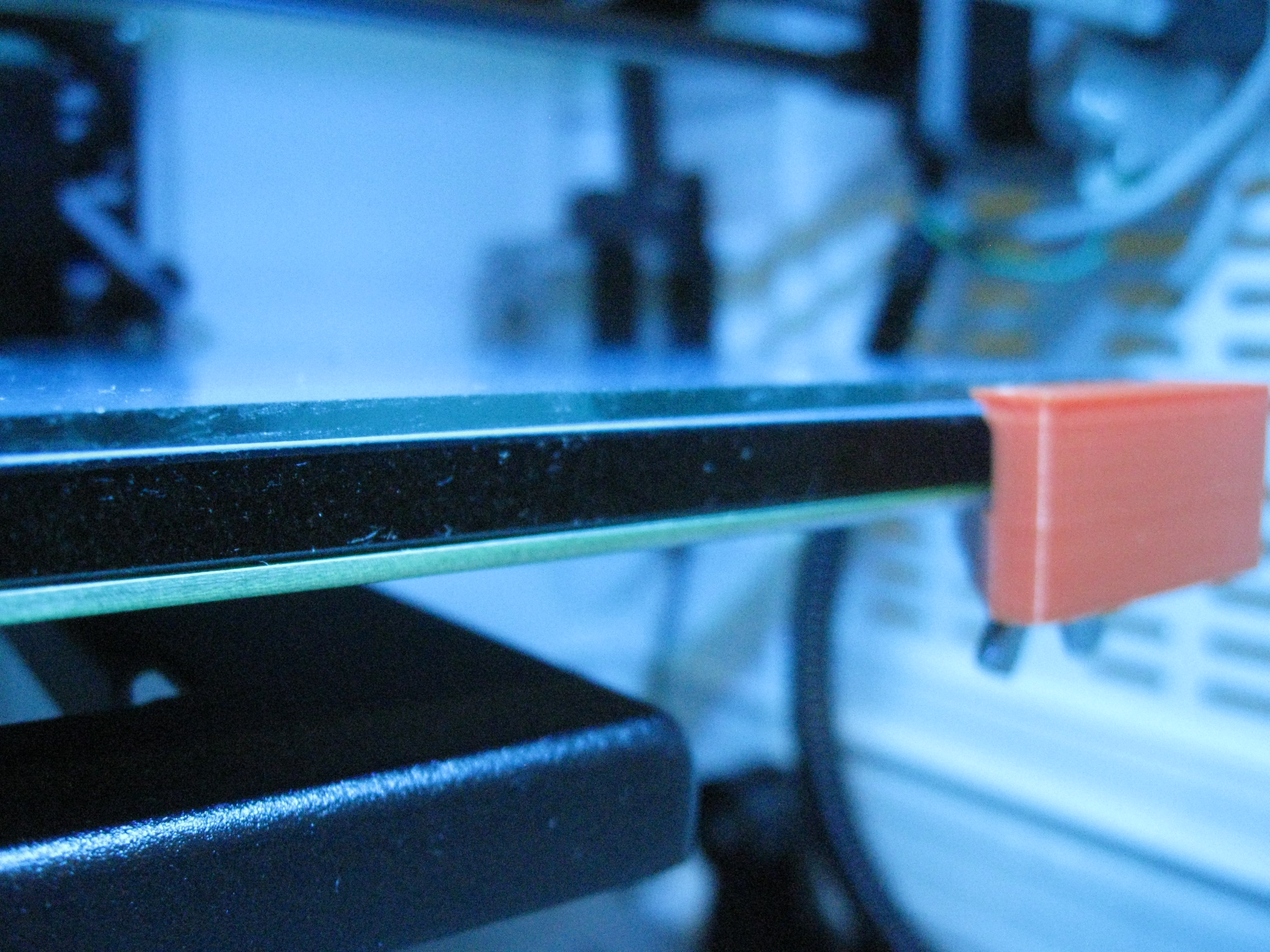

Glass plate Forget about even trying to print on anything else. Mine is 1/8"(3mm) thick others recommend 1/4" thick. if you use 1/4" you need to add a spacer block which activates the upper limit switch during “homing” or the extruder heads will hit the glass. With the 1/8" glass you can just turn the adjustment wing nuts to adjust for the extra thickness. I initially attached it with blue painters tape and sprayed hair spray on the tape to hold it down, thingiverse has 3mm glass holders you can print out, (2) needed front right and back left, wing nuts to attach them are included in your little tool kit box.

If you have never used glass I would highly suggest trying it. I have two pieces and if I am in a hurry to start another print I can remove one piece and put the other one in and go. I have found that 95C works great with glass and ABS. I designed my own glass clamps because the ones on thingiverse did not look like they would fit properly. if anyone wants the .stl file I would be happy to send it to them.

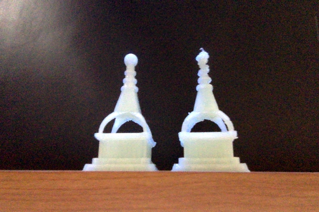

Haven’t had much luck with GLOW PLA at 190/30. Instead I’ve been printing at 210/50. The lower bed temps seem to cause some warpage of the base. I’ve also seen some good test prints with the fan OFF, however, for real prints, I’ve always had to keep the fan ON, which is what you want for PLA anyway. Attached is a good photo of a part (Eiffel tower top) printed at 210/50 deg C. The left pic is with the fan ON and right pic with the cooling fan OFF. Much better result with the fan on.
