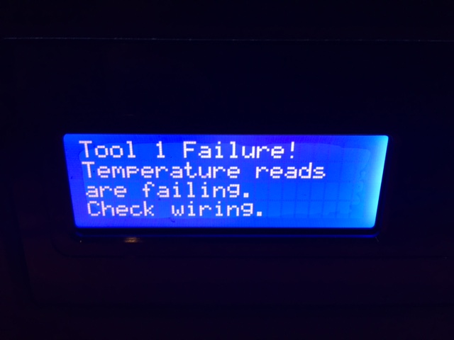

However when I wanted to load the left, I got the following message “Tool 1 Failre! Temperature reads are failing. Check wiring.”

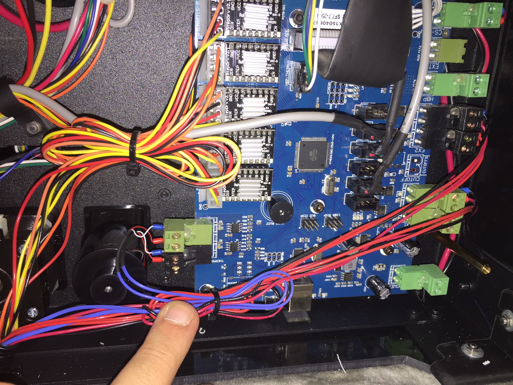

Is this referring to the thermocouple at the underside? one of the wires was loose, so i put it back again but the error still persists.

Your temp sensor wiring has an issue or your temp sensor is faulty. This has happened to me in the past, I would contact Flashforge they will walk you through the procedure for testing it.
The message means the temperature reads aren’t working the way the bot expects when it applies heat. This can be because the thermocouple isn’t connected correctly, is shorted or broken. It can also be the heater isn’t working or there’s a problem with a component on the motherboard. If it happens immediately I’d suspect the thermocouple.
you can go to monitor mode in the settings menu on the LCD and if the temp is wrong there it isn’t the heater. After that you can try the preheat and watch how the readings react. I _think_ you can see the reverse polarity there if the temp goes the wrong way.
Any case, you can check the connection at the motherboard and hotend. If you have a multimeter you can check the resistance of the thermocouple (unplug it from the motherboard first) as well as make sure there is no short to the heater block (infinite resistance).
I don’t have the expected thermocouple resistance handy but I think a bit of google forum searching will turn it up.

Thanks for the message. I found a loose wire in the thermocouple at the underside of the creator pro. I undid the screw and put it back. However the tool 1 error still shows up within 10 - 15 seconds each time I start the printer.
I have attached a picture of the bottom side of the creator pro. Does everything seem OK?
