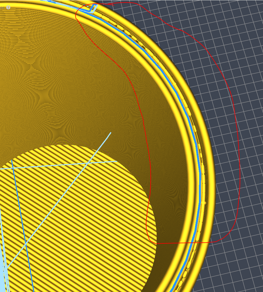

I am getting really good quality overall print when using cura except for these voids in layer start/ end. Its very annoying. In other programs like slic3r there is an opposite of void it has a blob like every other Z seam artifact. When I try it with cura there is a void. but it doesnt show up in layer view. I tried turning off retract on layer change, Retraction prime extra amount, coasting. retracting all together. The voids are always there when printer comes to layer end I had enabled all the settings in cura I have gone through everything there doesnt seem to any problem to my knowledge. is there any hidden setting that could be a culprit in the latest cura 3.2.1. Also I would like to point out a few weird extrusions on inner layer my printer makes. Please let me know what setting triggers this. I will copy paste all of my setting here as well. I really need to fix this

is there a function that does opposite of what coasting would does ? cuz that will definitely fix my voids
adding coasting default value adds the voids in layer view. Please help me figure this out. Thank you.
