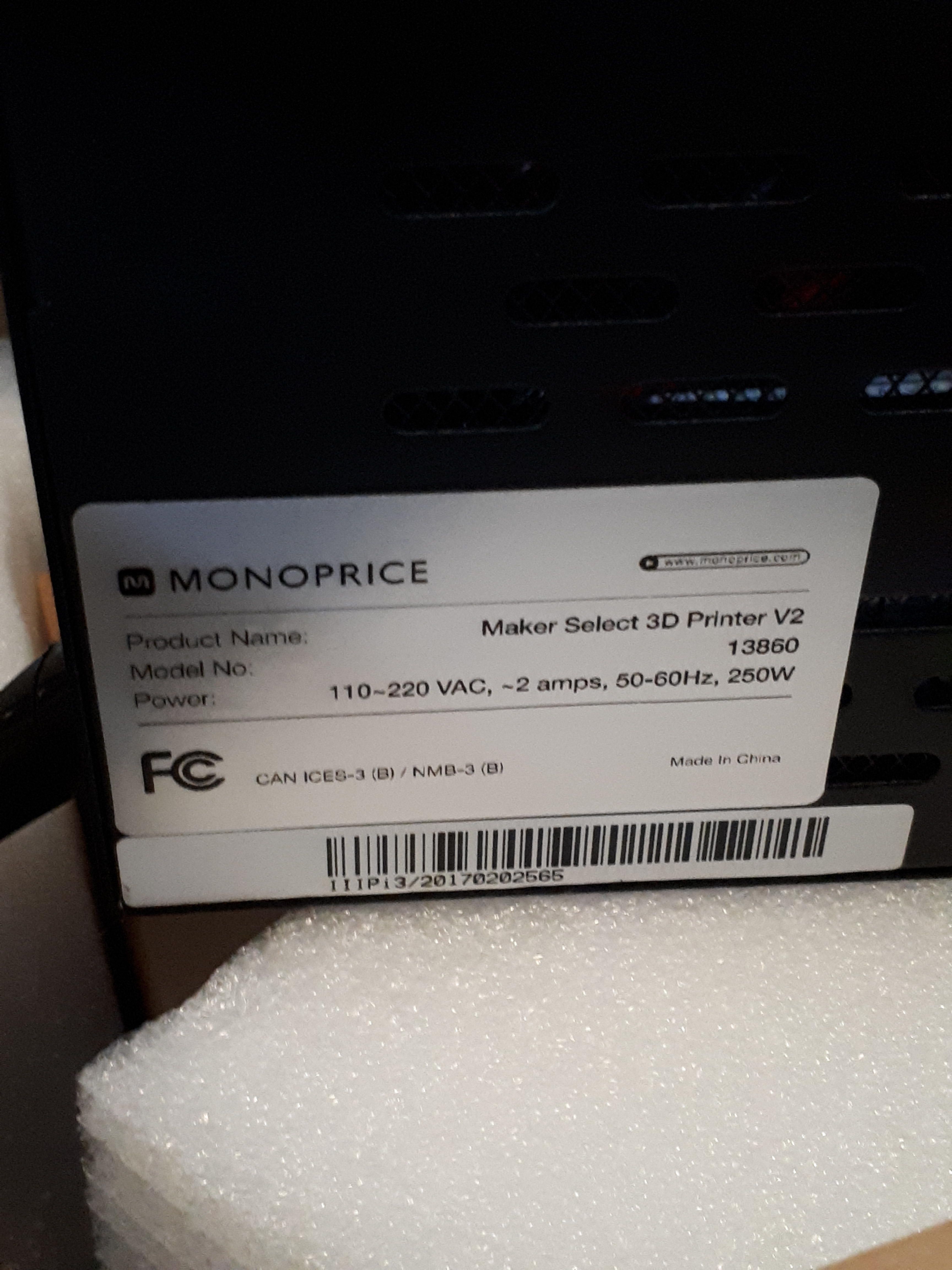

I just got my monoprice maker select v2. Im in Europe, so i’ll need to buy a transformer. I know nothing about electronics so I would appreciate if anyone could show me which transformer i need to buy. Ive provided pictures of the power supply.
I think before buying a transformer look to see if there is a switch to change from 110 to 220. It could be on the inside of it some where. Contact the seller or google for it.
Most have this now a days.
